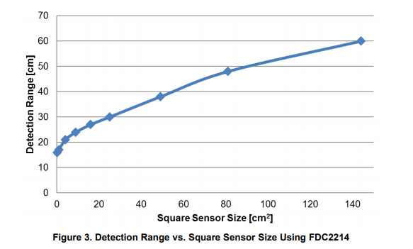

  • Hey Hyungbae,
    I think this part could do the trick for you. Below is a plot of the plate size characterization for different distances; the source document can be found here:
    Unfortunately, I do still have some reservations on the resolution of dampness to which you will be able to measure but I would bet you could detect a difference between wet and dry. The reasons for my concern are as follows:
    1. What is Wet?
    You will need to characterize the capacitance associated with the towel at every step from soaked to bone dry to really give a user a sense of the towel's moisture content. Think bone dry, semi damp, damp, very damp, etc... This is certainly doable and if it solves your problem then by all means try.
    2. Towel Position
    For this to work you will need to ensure that the towel stays in the same spot at all times. If only half of it is in front of the sensor you will need to be able to detect this and adjust the sensor values or your info will be incorrect
    All in all, I would say go ahead and give the eval board a shot to see if your idea works, it's only 30 bucks or there abouts.

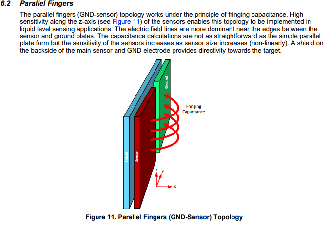

  • Hi Nick.
    today morning  one FDC2214EVM arrived .
     my finished job like this.
    Questions 1)  is how to design electrodes sizes and single or double side  and FR4 or FPCB?
    Questions 2 ) where i connected electrodes terminal A and Bin FDC2214EVM board?
    Questions 3 ) i need change firmware or not?
    Questions 4 ) do you have library for ARM, if you have can i get it?
    if i get the  this answer ,  I'm handling can do it.

    Designing one of these sensors is the same as designing a regular capacitor essentially. If you have a good understanding of electormagnetic theory you'll be golden. However, since it is always nice to have a guide, you can find a very detailed one located here. It sounds like your design will use parallel fingers model seen below:
