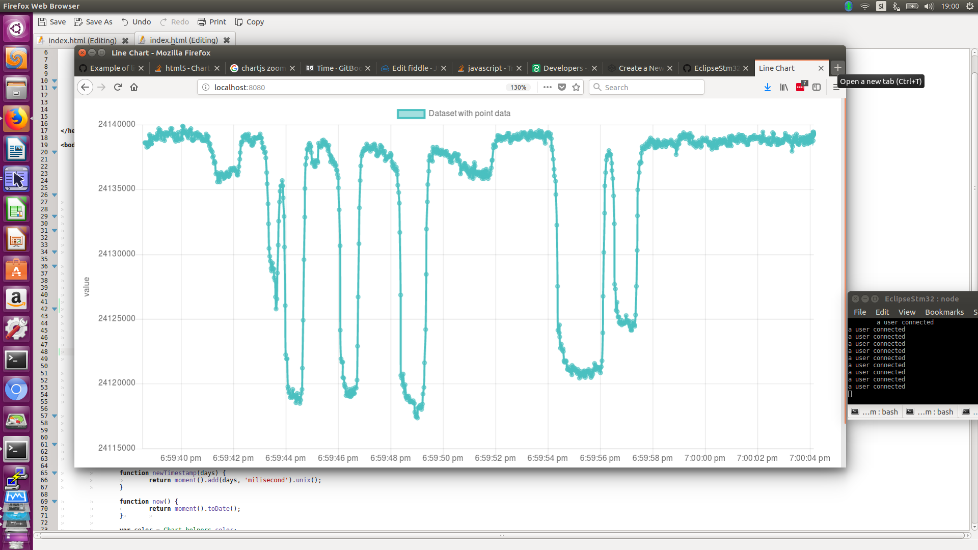

  • I actually haven't predicted to use external oscillator on my hardware.
    This are readings that I have from sensor.
    Since values are kind of drifting - I need to find good sample code to detect hand touch. So actually somthing to adapt to value of capsense when hand is not present near sensor.
    In bottom picture you see hand got near the sensor 5 times. So how would I go to define what vaule should be trigger value for detecting hand touch? Any idea?
  • I solved this latest problem by calculating long moving average of values and short moving average ov values.
    with this approach, software adapts to new (drfting) values. It works nicely now.
