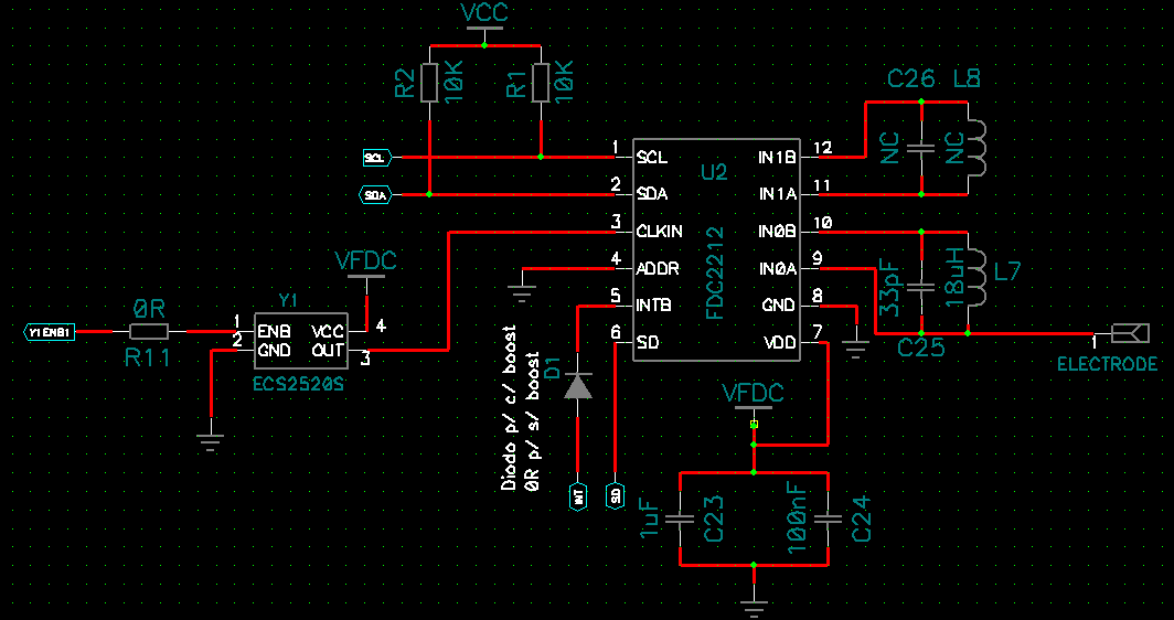

  • Hello Luke,
    Thanks for your help so far.
    1) I have designed a new PCB with a 10ppm external oscilator from ECS (ECS-2520S33-400-FN-TR) and the drift remains the same.
    2)  At LC tank we are using a 33pF/C0G/0402 and 18uH/ 0603/1.6 ohms (MLF1608C180KTA00). Do you think those are ok?
    3) Even though the serial resistance is higher (7.6 ohms), do you think a wirewonded inductor like 0603LS-183XGLB can help ?
    4) My electrode is conected to IN0, I am not using IN1 and I was woundering if I could use IN1 to cancel the drift by subtrating (In0 - In1 = In0 without drift and less noise) does it make sense for you? Is there any application note about that? If it make sense, what is the best configuration for In1 ( left floting without any electrode? should I place is close to shield or Ground?)
    5) If I decide to shield one side, where should I connect the shielding plate? On ground or in the IN0B?
    Following is the schematic for your reference:
    Renato
    We are
  • Hi Renato,
    33pF/C0G/0402 and 18uH/ 0603/1.6 ohms (MLF1608C180KTA00) sound reasonable to me. We do not recommend unshielded wirewounded inductors since a change in L also results in a change in sensor frequency. With an unshielded inductor, L could vary with the presence of metal nearby.
    The unused channel can be used for temperature correction. You could check out our Liquid Level Sensing Reference Design which uses reference and ambient sensors in the design.
    If you need to shield the sensor, you should consider our FDC1004 device, which comes with shielding drivers.

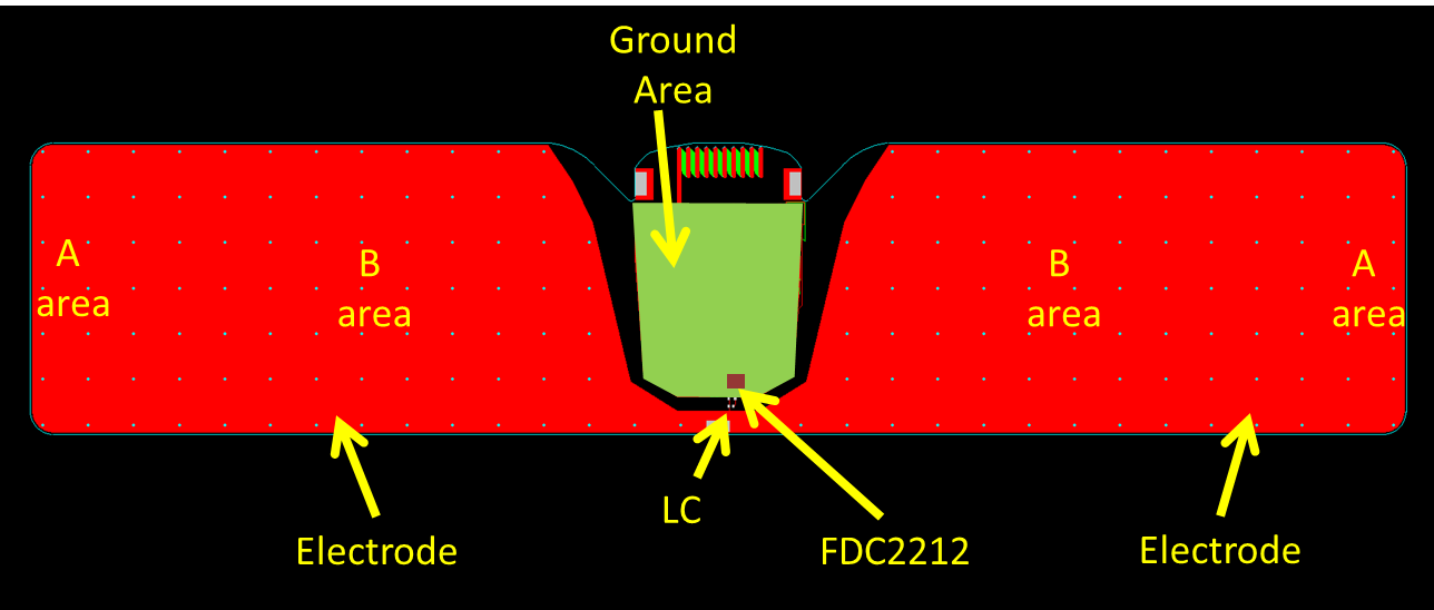

  • Jiashow and Luke,
    Thanks again for your help so far.
     We are experiencing an strange behavior in our electrode.
     See picture and some information below:
    1) That is a 30cm x 6.2cm, 2 layers FR4 PCB with 0.5mm thickness
    2) The electrode is full of vias (as you can see in the picture) in order to keep top and bottom conected with the whole electrode in the same potencial
    3) Electrode area is about 160cm2
    4) Ground area is about 9cm2
    5) We are using only one chanel of FDC2212
    6) That is a battery (CR2032) system with a step up converter to 3.3V (TPS610981)
    7) Our target is to identified a humam body proximity with 20cm distance.
     The point is, when I touch the "A area" (border) the readen raw value increases, when I touch the "B Area" (middle to center) the readen raw value decreases and when I touch the ground area, the value decreases even more. We can change electrode and increse groud area if necessary, could you give me a direction to go ?

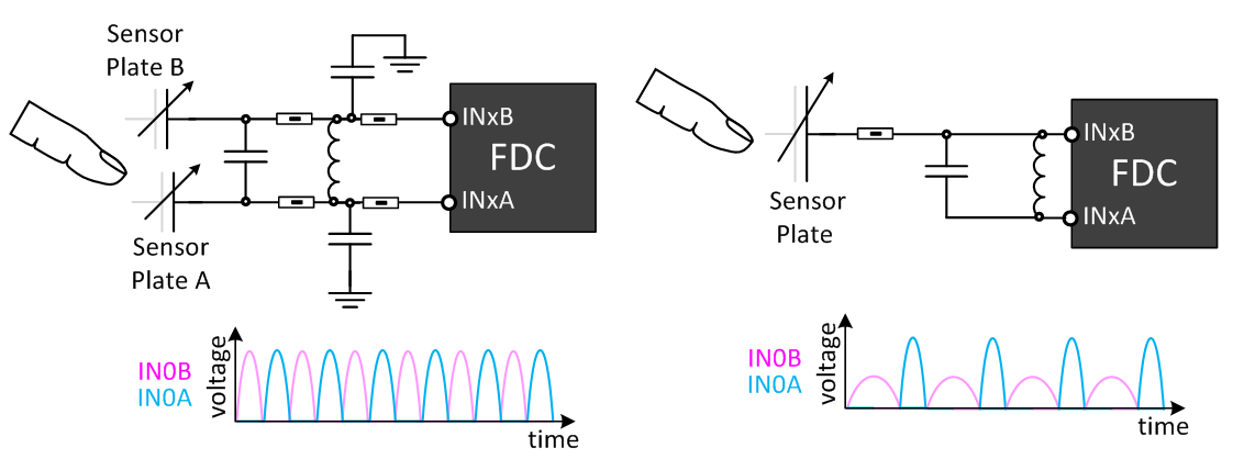

  • Hi Renato,.
    This may be due to transmission line effect and you may need to lower your sensor frequency. Could you provide your measured sensor frequency, sensor amplitude, and idrive setting so we have a better understanding of your system?
    In addition, because your sensor is quite large, we recommend using the balanced configuration by splitting the electrode into two equally sized pieces and connecting one to INA and the other to INB.

  • Jiashow,
      Thanks for your useful answer.
       The Balanced configuration works great and we got a much better SNR comparing to single plate configuration.On the other hand, we have  also tried a parallel finger configuration (with half eletrode conected to InA and other half conected to ground and the behavior looks quite similar to balanced configuration.

  • Hello Renato,
    At this time we don't have an app-note on balanced sensor configuration, but we find it to be superior for a wide range of applications.
    For the sensor design, you should ensure that the two sections of the sensor are equal in area; this provides optimum sensor balancing across temperature and other effects.  The balancing will ensure good matching on the A & B driven phases- with an unbalanced configuration the amplitudes can vary significantly, which can increase the noise level.
