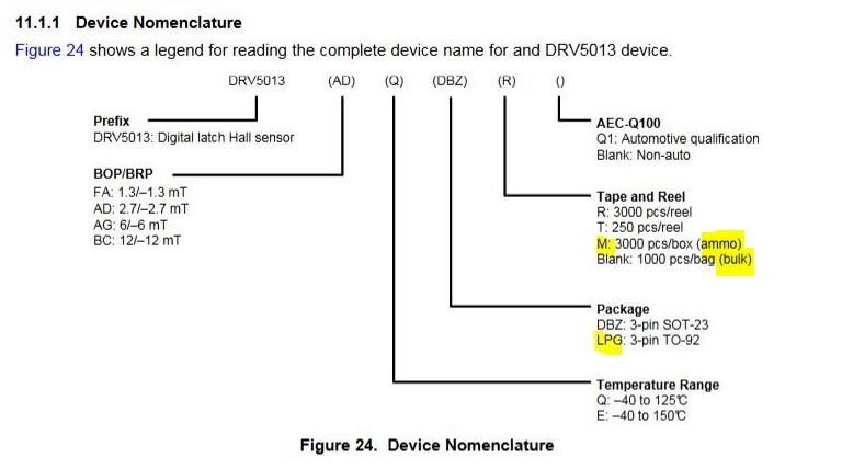

May I know the DRV5013 PCB Layout pattern differet with LPG and LPGM?
Thanks.
