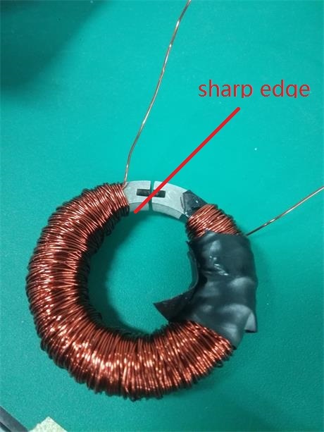

I made some samples with DRV421,2000turns coils. but the test results was not right, the output for one sample was 4.96V, the other was 26.7mV, it was wrong ,it should be 2.5V.
why i have these unnormal results? it is because the IC welding unreliable ? the supply power was 5V. thanks very much!

  • Hello Jie Qian,
    I noticed that you have both a pull-up and pull-down connected on the GSEL* pins. So the GSEL pins are biased at mid-supply which is not a valid logic state. Each pin can either be logic high (~5V) or logic low (~0V). Please set the states of these pins properly for a valid gain setting.
    Harsha

  • Jie Qian,
    You have a 1nF cap load connected directly to the REFOUT pin which is most likely causing the internal reference source to oscillate. To find out whether this is the issue you can simply remove the 1nF cap on REFOUT. For low-pass filtering the reference input to the current sense amplifier, the cap should be connected to the REFIN pin, not REFOUT.

  • Hi Jie Qian,
    GSEL and inductance set AC loop transfer characteristics. Based on your data your DC transfer gain (Nprim/Nwinding x Rshunt x 4V/V) seems to be incorrect. Please check the values of Rshunt and Nwinding. I suspect that you have only 225 or so turns instead of 1000. Also are you sure your primary current is accurate? I would recommend verifying with an ammeter at a low current setting on your source.

  • Hi Jie Qian,
    Can you share the dimensions and material of your core. I can simulate to get the expected inductance. The inductance you mentioned 0.9mH seems too low. Our part works with inductance between 100mH- 2 H. At 1KHz test should be fine. Did you test the inductance with it not connected to the DRV421 Icomp pins?
  • Hello !Harsha!
    you are right, the coils have some promblems ,i check the inductance of the compensation coils with LCR, it was only about 10mH, obviously ,the coils was shortcircuit,caused by the sharp edge of the magnetic core. i made  another coils with 1000 copper turns,and the inductance i checked with LCR was 100mH, it seems  more noramal, and the test result please see the figure below, do you think it 's ok? or have something to do to improve the accuracy?
