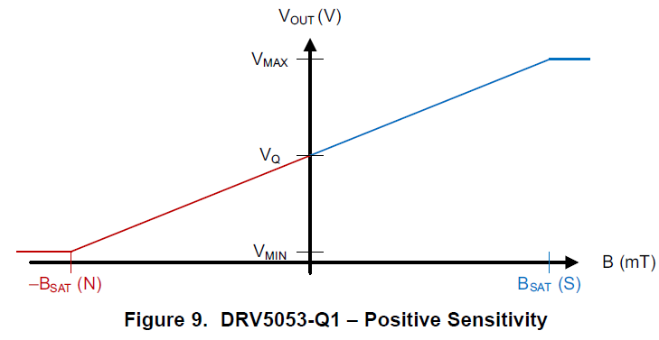

I got DRV 5053 Hall effect Bipolar analog output magnetic sensor.
I want to know what is the Minimum and maximum gauss value of sensing...??
Yuvaraj
  • Yuva,
    First determine what sensitivity variant of the device you have. For example, the EA variant (DRV5053EA) has a typical sensitivity (S) of 45 mV/mT.
    Also note, that the output voltage will not exceed 1.8V or go below 0.2V. Also, at 0-Tesla, the output voltage is 1.02V (VQ) typically. Since the output is linear you can determine the typical minimum and maximum gauss values with following equations:
    Max gauss sense = (1.8V - 1.02V)/S = 17.33 mT
    Minimum guass sense = (0.2V - 1.02V)/S = -18.22 mT
    Please read through datahseet for more information.
    Also note, that the calculations above are with typical values. The sensitivity (S) for EA variant can at a maximum be 70mV/mT. You will need to design for this worst case, or calibrate/measure the sensitivity of your device. The quiescent output (VQ) can also vary slightly.
