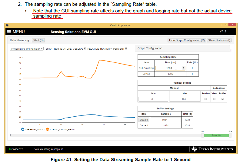

My customer wants to set sampling rate of measurement (temperature, humidity) with half an eye on Data streaming screen.
Is there any way to achieve it?
It seems the following "sampling rate" isn't actual device sampling rate.
The background of the question is to confirm self heating of HDC1010.
Yaita / Japan disty
  • Dear Yaita-san,
    Unfortunately at the moment is not possible to modify the sampling rate of measurements from the Sensing Solution EVM GUI.
    But for this purpose, you can use the old GUI (not supported anymore), that you can download from the following link:
    6763.snvc172.zip
    In this GUI it is possible to modify the sampling rate of the measurements:
    Please let me know if this solves the issue.
