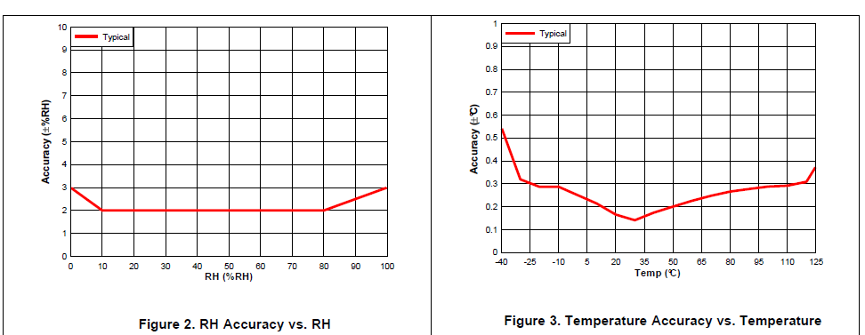

hi sir,
1. what's the definition for the device of typical accuracy value, such as how many percentage device accuracy data is in this typical range,  we see other competitor device SPEC have maximum accuracy Curves.
do you have MAXIMUM value of accuracy data in you internal test. our customer need refer it.
2. for soldering for HDC2010
spec mentioned"The HDC2010 must be limited to a single IR reflow and no rework is recommended." this request is only for HDC2010, or for all of r Humidity and Temperature sensor.
2.
  • Hi Lina,
    1. Typical is a common term used for "average" unit across all population. We do have MAX values for relative accuracy (RH) and Temperature accuracy. +/- 3% RH and +/-0.4C for temperature. Please refer to the table and foot notes in page 5 of the HDC2010 data sheet.
    www.ti.com/.../hdc2010.pdf
    2. This requirement is for the HDC2010. All other devices may have similar or same recommendations bu you need to check their respective data sheets. For more details on handling the humidity sensing ICs please refer to the following application notes.
    Humidity Sensor: Storage and Handling Guidelines --> www.ti.com/.../snia025
