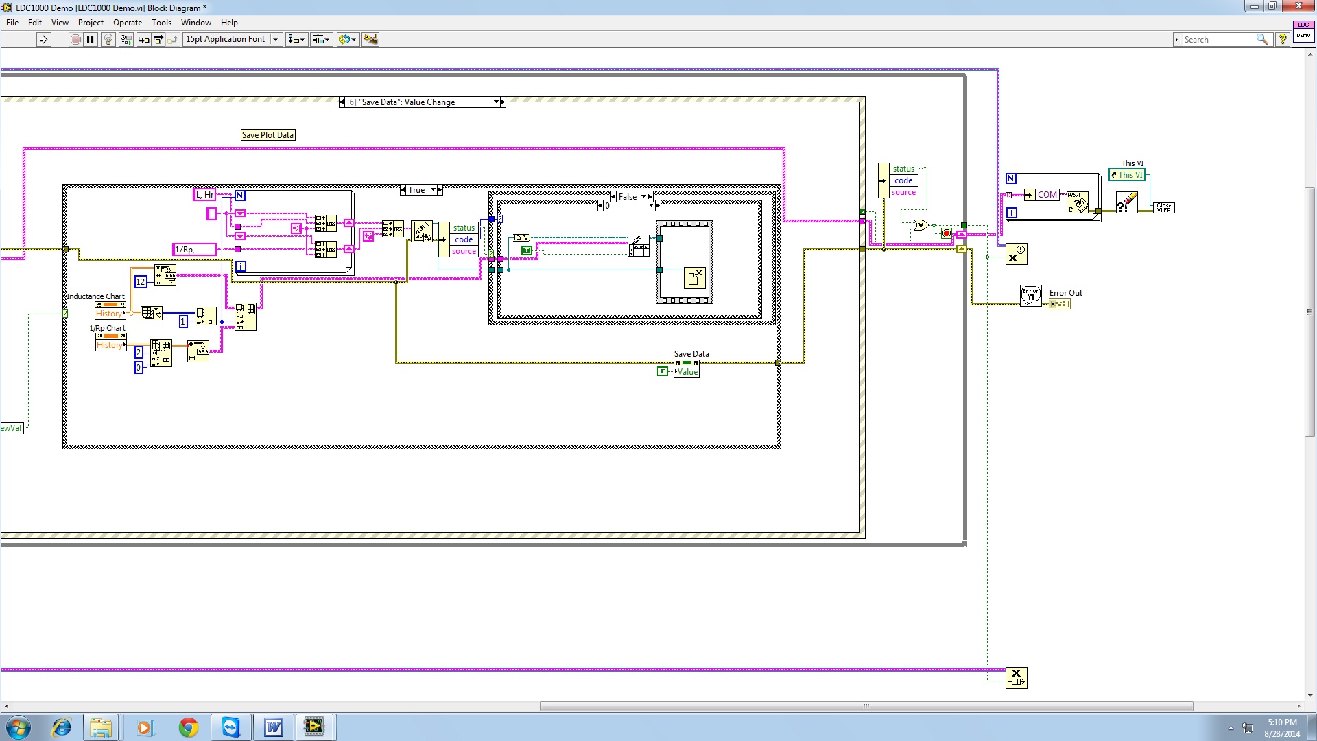

  • Hi
    I am using LABVIEW GUI ALRIGHT BUT I AM NOT ABLE TO SAVE DATA TO LVM FILE OR EXCEL FILE THROUGH SAVE BUTTON. Please give a solution for the same. regards
  • Hi Pravat,
    Please go to Save Data Event
    Pull Status from Unbundle, wrap another case structure around the existing one, that is based on code status.
    So, if there's no error, it does not go into checking for the code. The code is generated occasionally on slower machines, when VISA generates data faster than it's consumed. GUI bug.
  • When i use save button i get an error "cannot write to this file. please make sure its not open in another application and you have sufficient rights to write to it" though the file is not open in any program. I tried to modify the program as per your suggestion but it did not work, block diagram attached. Kindle give a simple solution or  modified program.
    regards
    pravat
  • Pardon me for not being exact with my wordings.
    Here's what I meant:
    Grab the content of Case 0 and place it into False case of error status.
    Keep the rest of the code-based case structure in the True case of error status. Like this:
  • Hi Evgeny
    your reply is not complete as  you have some thing more to write after like this i suppose.please give an pictorial explanation for what i have to do to coorect the labvie code or give an corrected code so that i can download it and save date from ldc1000 evm in LabVIEW for future application.
    pravat
  • Hello Pravat,
    you are right, it cut off the images.
    I'm not in the office this week so cannot re-post the images right away.
    If you are in a hurry, please just follow the verbal description, and post the modifications if they don't work - I will help you out if something is wrong.
  • Hi
    the modification suggested are not clear so you come back to office and then post the images then only i will proceed to next step. i will wait for a week.
    bye
    pravat
