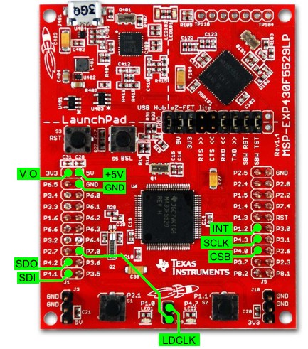

I only want to modify the LDC1000 register via EXP430F5529LP and CCS v6.0.
and following below picture to connect  EXP430F5529LP and LDC1000.

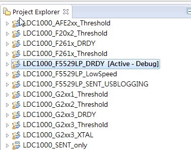

(1) I find sample code from Ti's web, http://www.ti.com/litv/zip/snac059.
     And import all projects,which project should i build ?
I build and debug LDC1000_F5529LP_DRDY first, and the register column shows the EXP430F5529LP register, not LDC1000 register.

  • Hello Yulin,
    The connections needed from MSP430 to LDC1000 are shown in the figure 2, page 2 of the LDC1000 datasheet.

  • Hi, Natallia:
    Should i import the LDC1000_F5529LP_DRDY project to modify LDC1000 register?
    thanks.
  • Hi Yulin,
    Yes, DRDY register tells you when the data is ready.

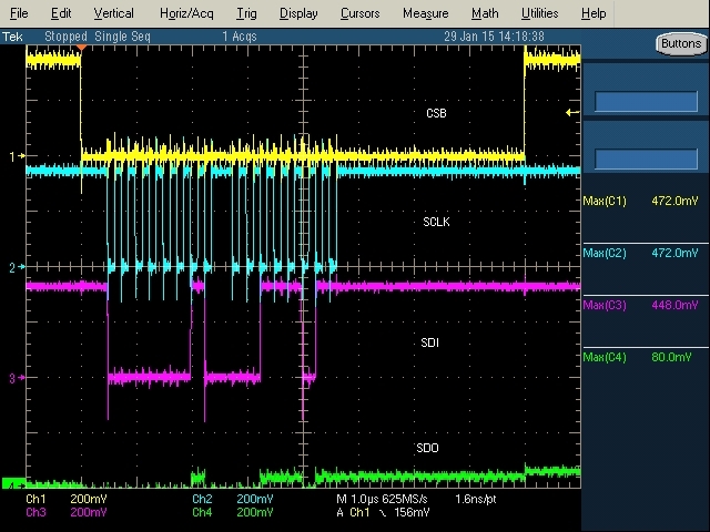

  • Hi Natallia:
    I measured 4 pins ->CSB,SDI,SDO,SCLK, the probe is 10X.
    pictures as below:

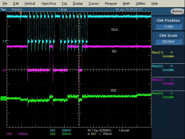

    (1)plug in USB between launchpad and PC:
    (2)After debug:
    (3)Press resume button:
    (4)After press resume button:

  • Hello Leo,
    I am not sure I clearly understand what you are trying to solve. The communication on figure 3 looks fine, besides the fact you need to show SDO.
    Natallia Holubeva

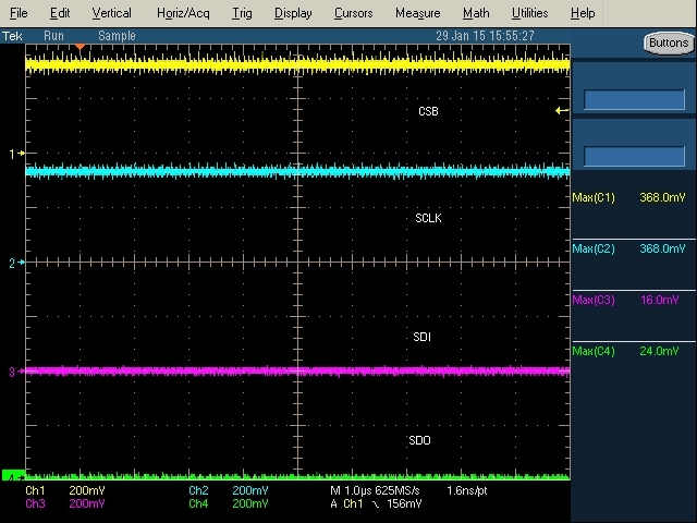

  • Dear  Natallia:
    Upload the no.3 SDO image clearly.
    And i don't know when i resume the code(no.4 image) , the there are no signal appear.(CSB,SCLK is High...SDI,SDO is Low)
  • Hello Leo,
    Based on the scope shot, you are writing the data to the LDC1000. There is nothing wrong going there. Please, try reading the data from LDC1000. Try reading the device ID to make sure you have a proper communication with the chip. SPI interface is described on the figure 17, page 19 of the datasheet.
    Natallia Holubeva
  • Hi Natallia:
    (1)I used the step over(F6) function to execute code, and find the picture 3 waveform is executing evm_test(); code  in main.c  column 169.
    And the waveform become no signal(picture 4.) when i executing next column code.

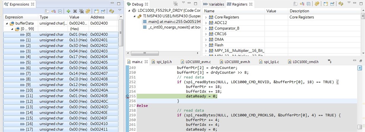

    About read/write LDC1000 registers, please see the picture as below.
    I want to see the LDC1000 18 registers( Device ID to Frequency Counter Data MSB) in datasheet page.14, so i modify LDC1000_F5529LP_DRDY main.c code
    column 252 to 255.
    (1)Is this code modify appropriate(column 252 to 255 )?
    Now i can see the registers(address 0x00~0x0B) appear, but the registers(0x20~0x25) this six registers  data value is zero,no data appear.
    (2)What's wrong with code that i changed?

  • Hello Leo,
    You are able to read registers(address 0x20~0x25) but however you are not seeing the data in the right place. You can try the following:
    if (spi_readBytes(NULL, LDC1000_CMD_STATUS, &bufferPtr[0], 6) == TRUE) {
    bufferPtr += 8;
    bufferIdx += 8;
    dataReady = 0;
    (at columns 252 to 255)
    This basically reads 6 bytes of data starting from address 0x20 ( LDC1000_CMD_STATUS), i.e 0x20 to 0x25.
    Now you will be able to read registers(address 0x20~0x25) at bufferData[0] to bufferData[5]. You can put a break point like before and check if you can read it. Let me know if this clarifies your doubt.

  • Hi, Suhas R C:
    Thank you for your reply.
    Now i can read registers (0x20~0x25), like picture as below:
    And i want to ask you two questions:
    (1) LDC1000_CMD_FREQCTRMSB (0x25) bufferData[5]  is no data change, it means the Frequency counter data is 0x001A81 ?
    (2) So i can't read all registers at once, need to separate readout (0x00~0x0B and 0x20~0x25) twice?

  • Hello Leo,
    That is great!
    (1) Yes, it says the Frequency counter data is 0x001A81.
    (2) You can read all the registers at once but you need to alter the way you save the data in variable "bufferData". You can try the following in columns 253 to 265 :
    if (spi_readBytes(NULL, LDC1000_CMD_REVID, &bufferPtr[0], 12) == TRUE) {
    bufferPtr += 8;
    bufferIdx += 8;
    dataReady = 0;
    if (spi_readBytes(NULL, LDC1000_CMD_STATUS, &bufferPtr[12], 6) == TRUE) {
    bufferPtr += 8;
    bufferIdx += 8;
    dataReady = 0;
    Now, you will be able to read all the registers at once. You can put a break point in the 2nd "if" statement, read the values and verify it.
    You were not able to read all register values at once earlier as you were overwriting the previously obtained register values.

  • Hi, Suhas:
    Ok ,now i can read all the registers at once.
    Thank you for your great help.
