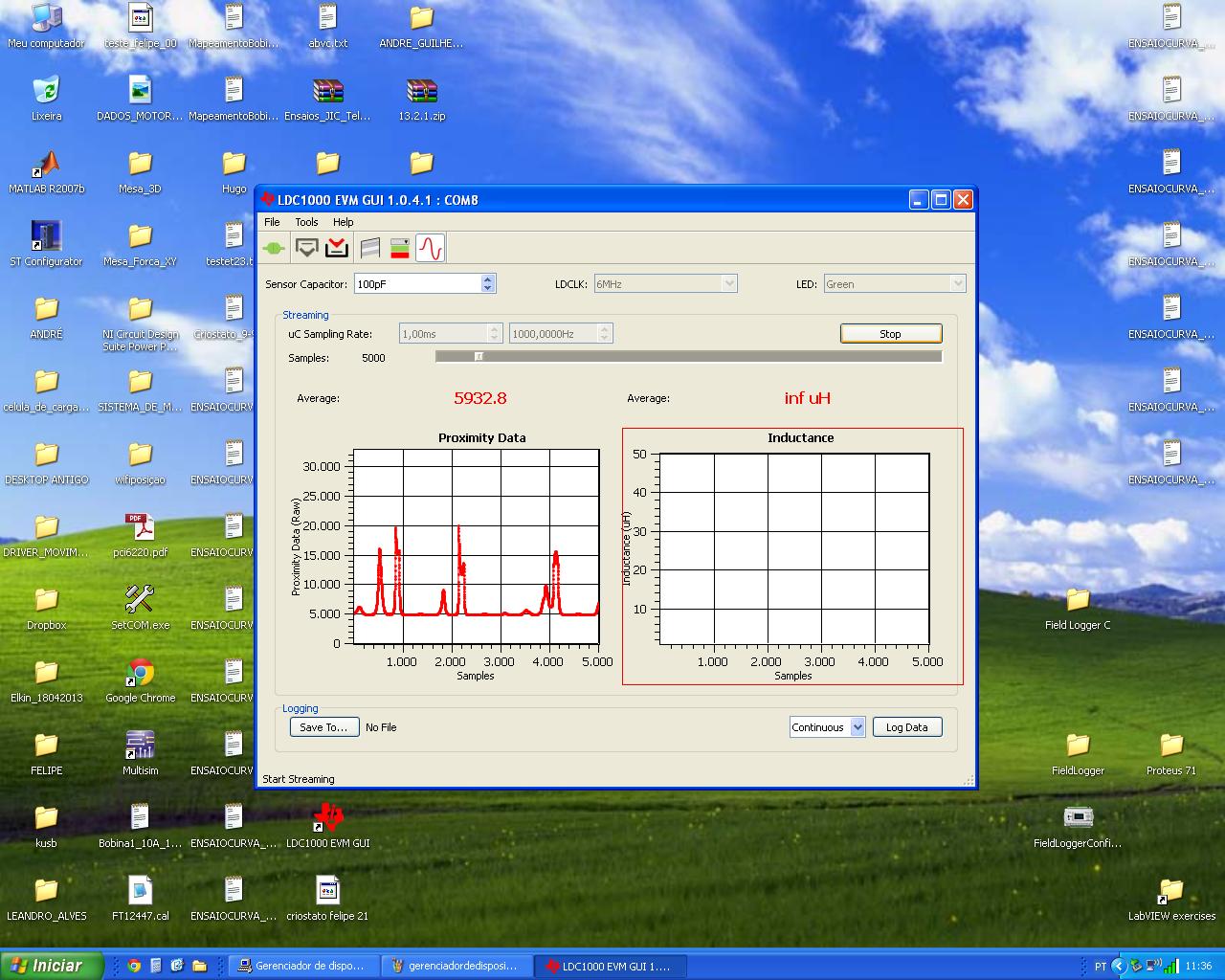

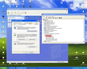

    I uninstalled and reinstalled the GUI for three times but the problem continues. My greatest urgency is the installation of the GUI on the desktop with windows Xp because it is this one that I use at work. I'll send to you pictures to show you what's happening. In the picture "gerenciadordedispositivo_EVM" is showing that the LDC1000EVM is recognized. And in the picture "LDCGUI_indutancia" is showing that the inductance is not being measured. So, the real problem is the inductance measurement by the GUI. Do you think it would have any software that I could install to correct this problem?

  • Hello Tamiris,
    Are you able to read the proximity data? If you could post the screen shots, that would be helpfu. Please use 'rich formatting' to do so.

  • Sorry Natalia, I forgotten the images. Are these.
