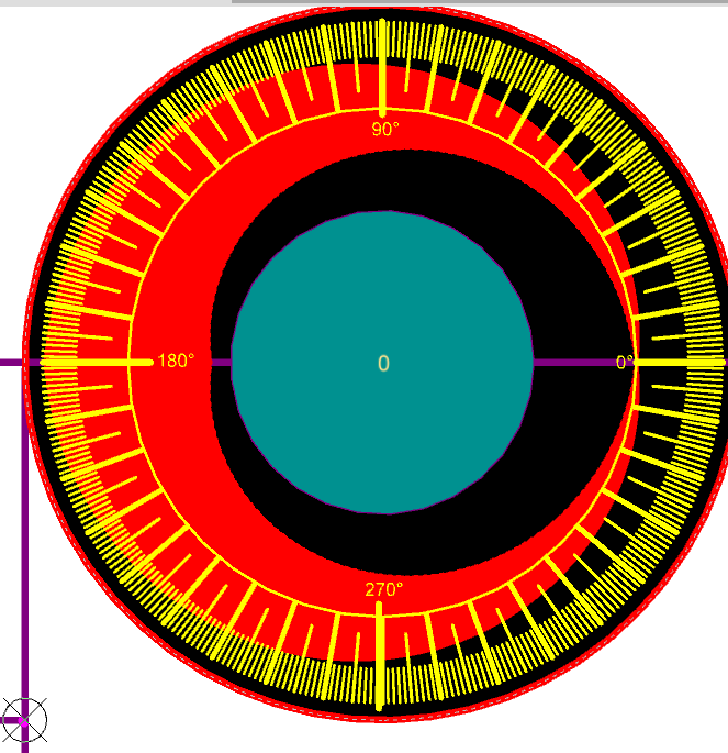

    For a rotation application in which you need full 360 degree measurement, you will need multiple sensors and either a multi-channel LDC or multiple LDC1000s. If you use 2 sensors, they should be 90degrees separated.
    As for the target shape, consider a target shape in which you have a width=k*angle (the red area corresponds to copper):

    There are several considerations that are present - first, is this a static measurement (i.e. the measurement is performed while the disk is NOT rotating) or with a continuously rotating object?
    For higher resolution, you will want to have 4 LDC channels spaced at 90degrees, in a Q+/Q- and I+/I- orientation. The LDC can provide 16bits of resolution, but you need to carefully map that electrical resolution to the mechanical system resolution.

  • Hi Golem,
    0.1degree accuracy may not be easy to attain. I expect you will need to use at least 4 channels of LDC in a differential quadrature arrangement, along with some software calibration.
