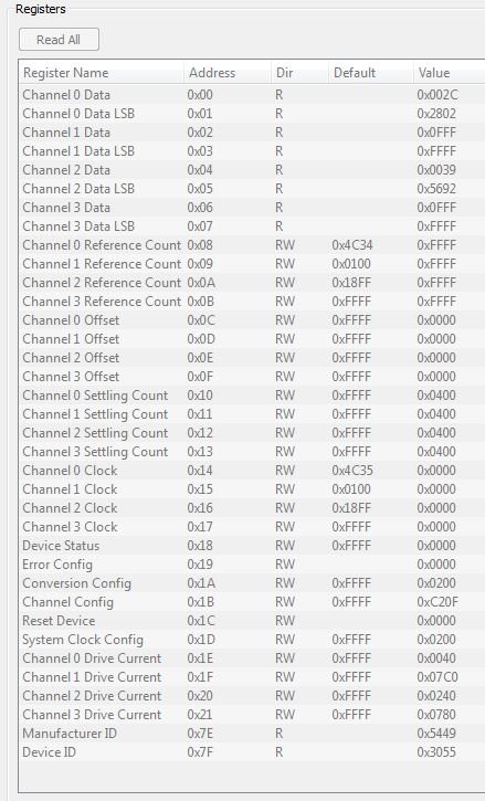

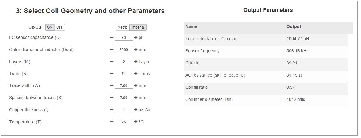

The above picture shows the design specifications of the coils. I started playing with them as soon as I received. I found that coil 1, 3 are not responding (always shows 0uH approx ) Can someone tell me what might be the reason. I am attaching the screenshot of the GUI below

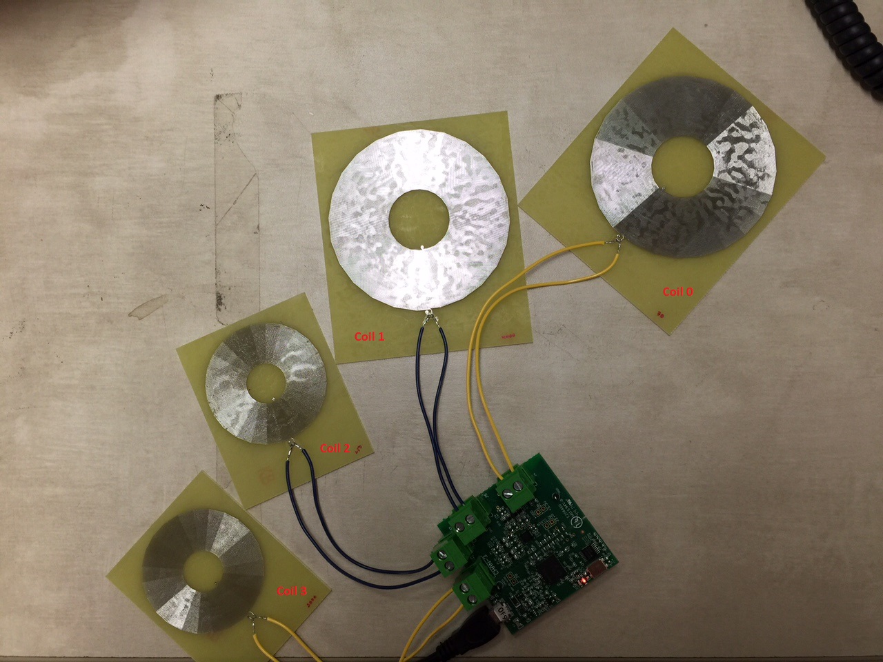

My sensor evaluation setup is as shown below:
I am simply evaluating which sensor design best suits my application. So, I need to verify if coil 1,3 are valid designs.
