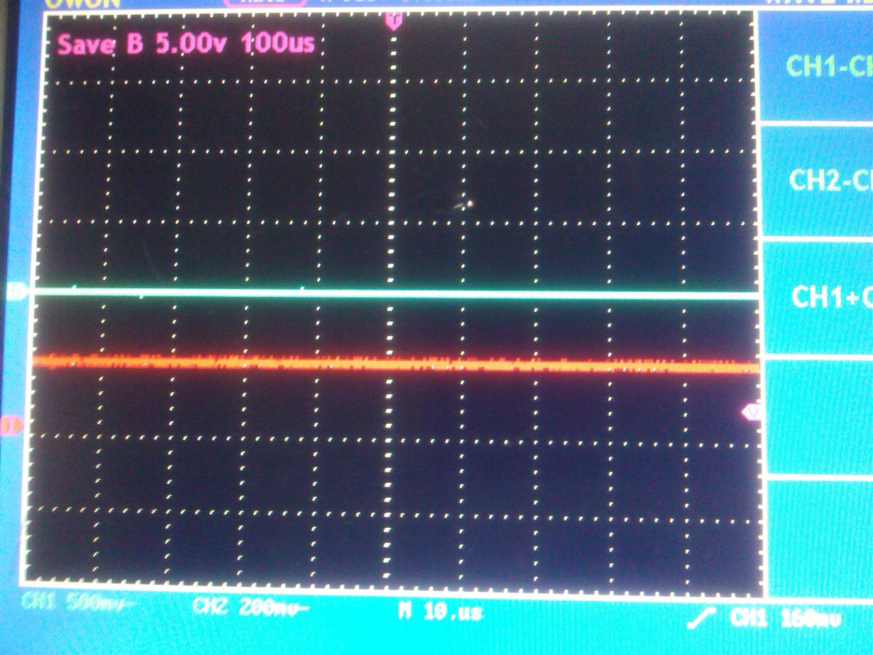

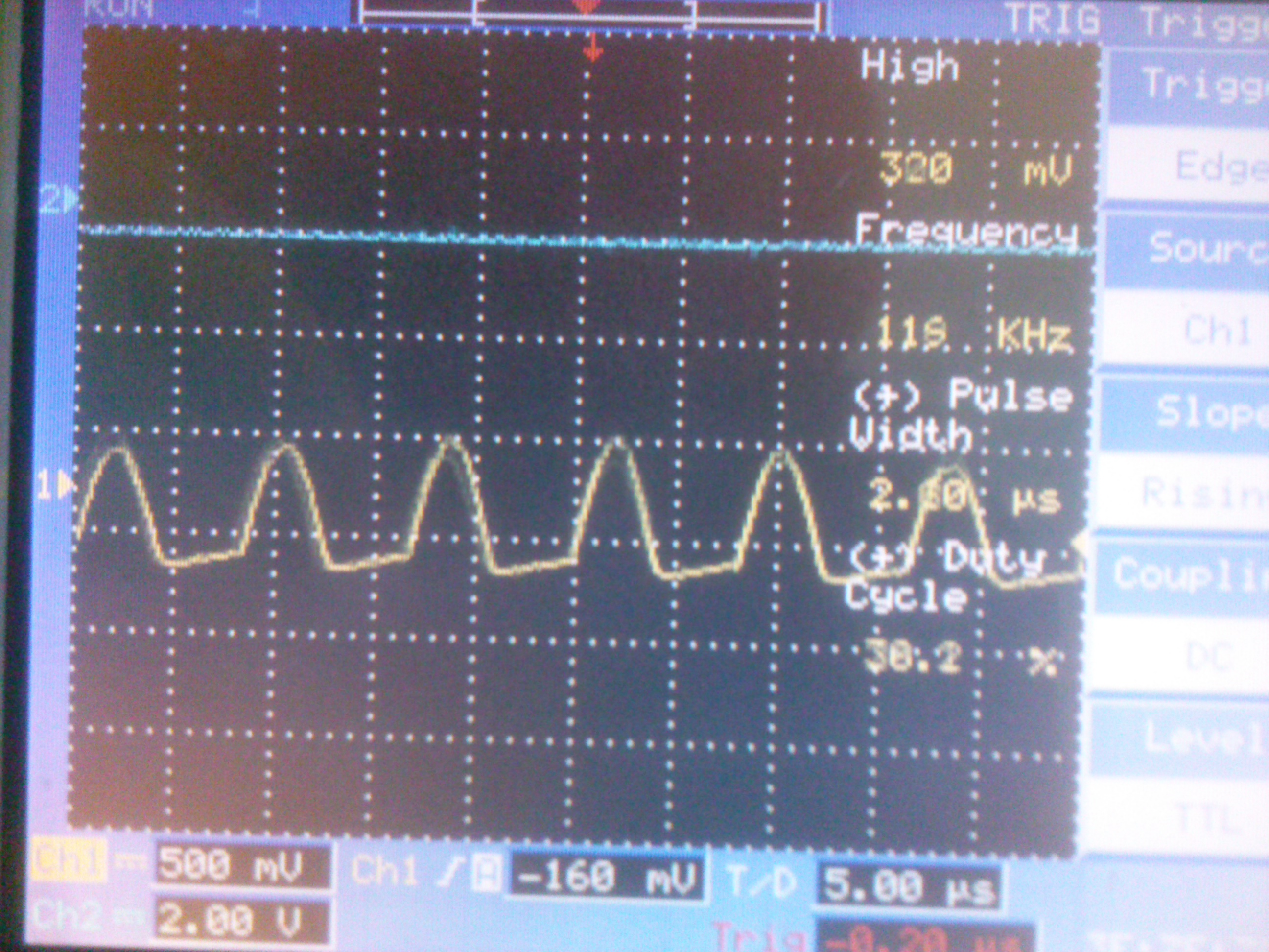

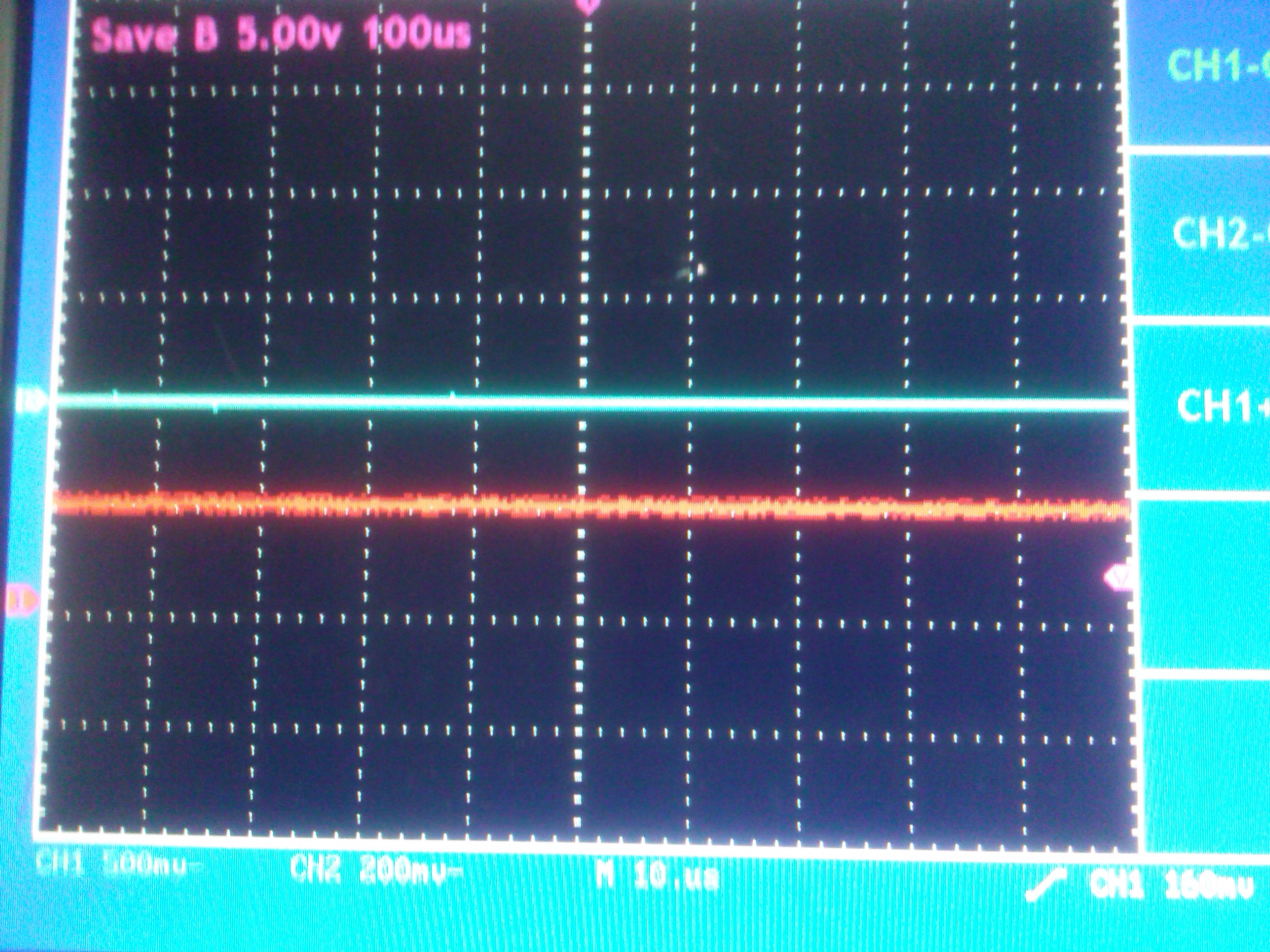

  • Hello Varban,
    Can you post INA pin and CFB screenshots for these two ICs?
  • Hello Evgeny,
    Thank you for your fast response! Here are the screenshots you have requested.
    LDC1000-Q1 IC1, INA:
    LDC1000-Q1 IC2, INA:
    LDC1000-Q1 IC1, CFB:
    LDC1000-Q1 IC2, CFB:
    On both of the LDC1000 ICs the measured voltage amplitude was 500mV  (1k resistor was used in series between the pin and the probe for the measurements).
    The two CFB capacitors are 10nF (0603 package).
    Kind regards,
    Varban

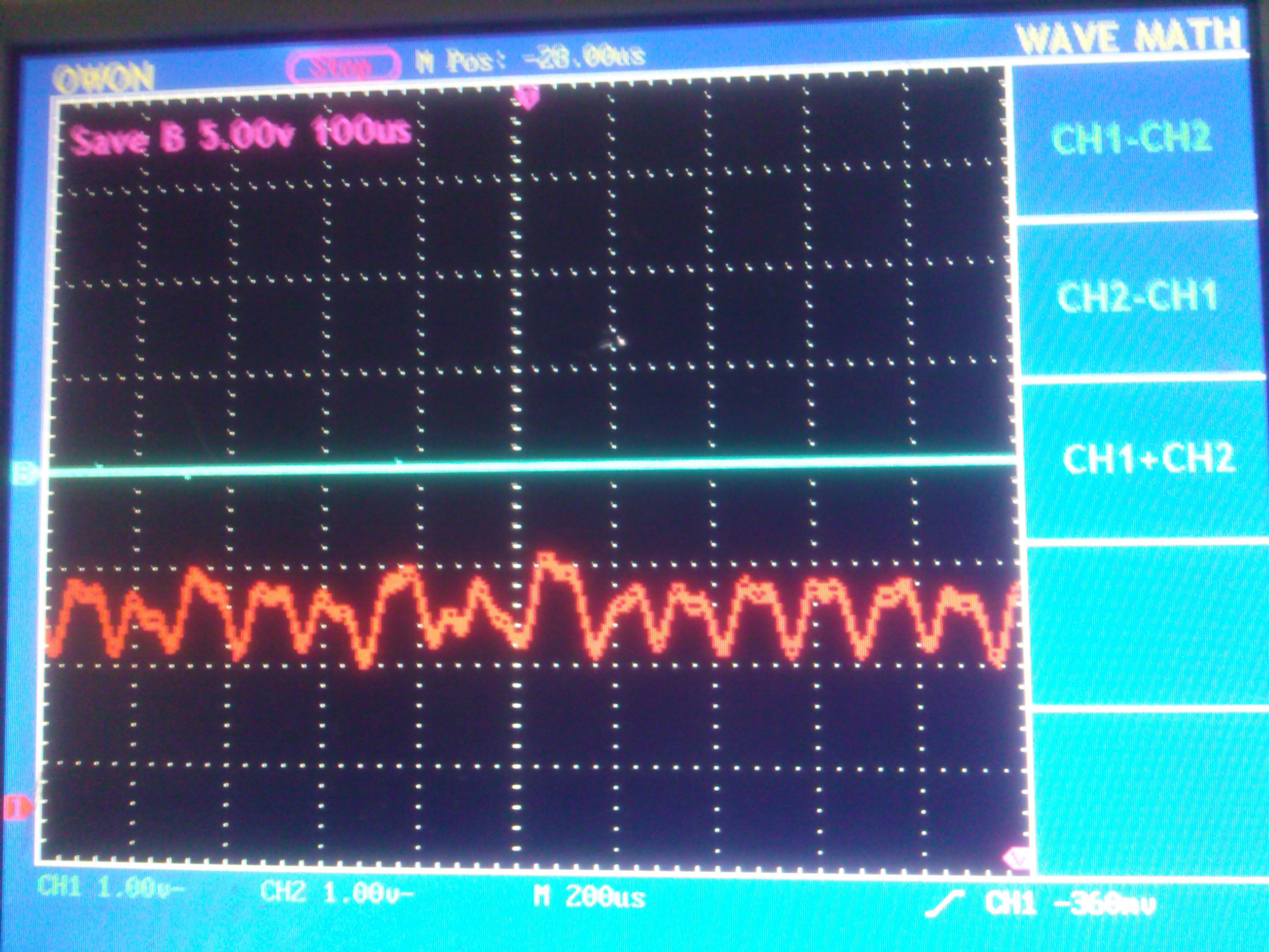

  • Hello Varban,
    A couple of things:
    1) When taking these screenshots, please use the time scale such that you can see an envelope riding on the sine wave. Usually it goes from 2.5V to 4V. Seeing a time scale (hidden in the above shots) would help me to provide recommendation.
    2.CF values are incorrect - there's no oscillations at all. Please follow the procedure from the DS to adjust CF values.
  • Hello Evgeny,
    Thank you for your help.
    About the first point: Could you possibly send me a sample screenshot with the expected sine wave - I do not understand what you mean by "scale such that you can see an envelope riding on the sine wave" ?
    About the second point: I replaced the 10nF capacitors with 4.7nF ones - the result is still the same - there are no oscillations.

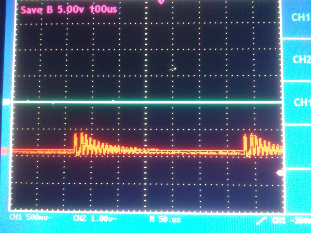

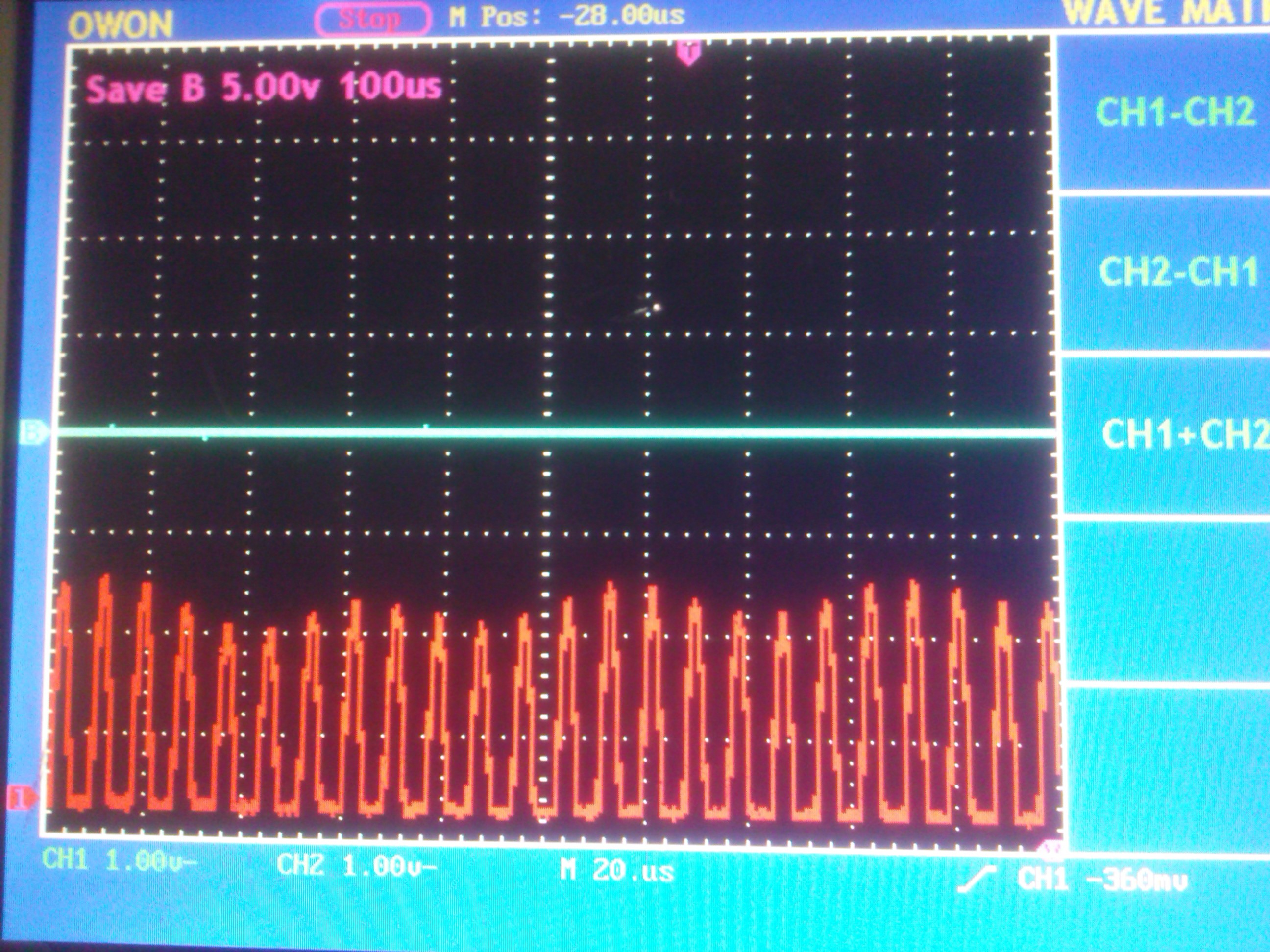

  • Hello Varban,
    The LDC1000 alternates between 2 current drive settings; if you look at multiple cycles of the sensor waveform you will see an envelope. For example, if your sensor frequency is 1MHz, which is a period of 1us, and your scope is looking at a timescale of 50us, then you should see a triangular type envelope on the sensor 1MHz. Please look at figure 4 in www.ti.com/.../snaa221, which shows the envelope Evgeny is referencing.
    ChrisO
    Here are some screenshots with 560pF and 860pF  capacitors correspondingly between INx pins:
    LCD IC1, 560pF:
    LDC IC2, 860pF:

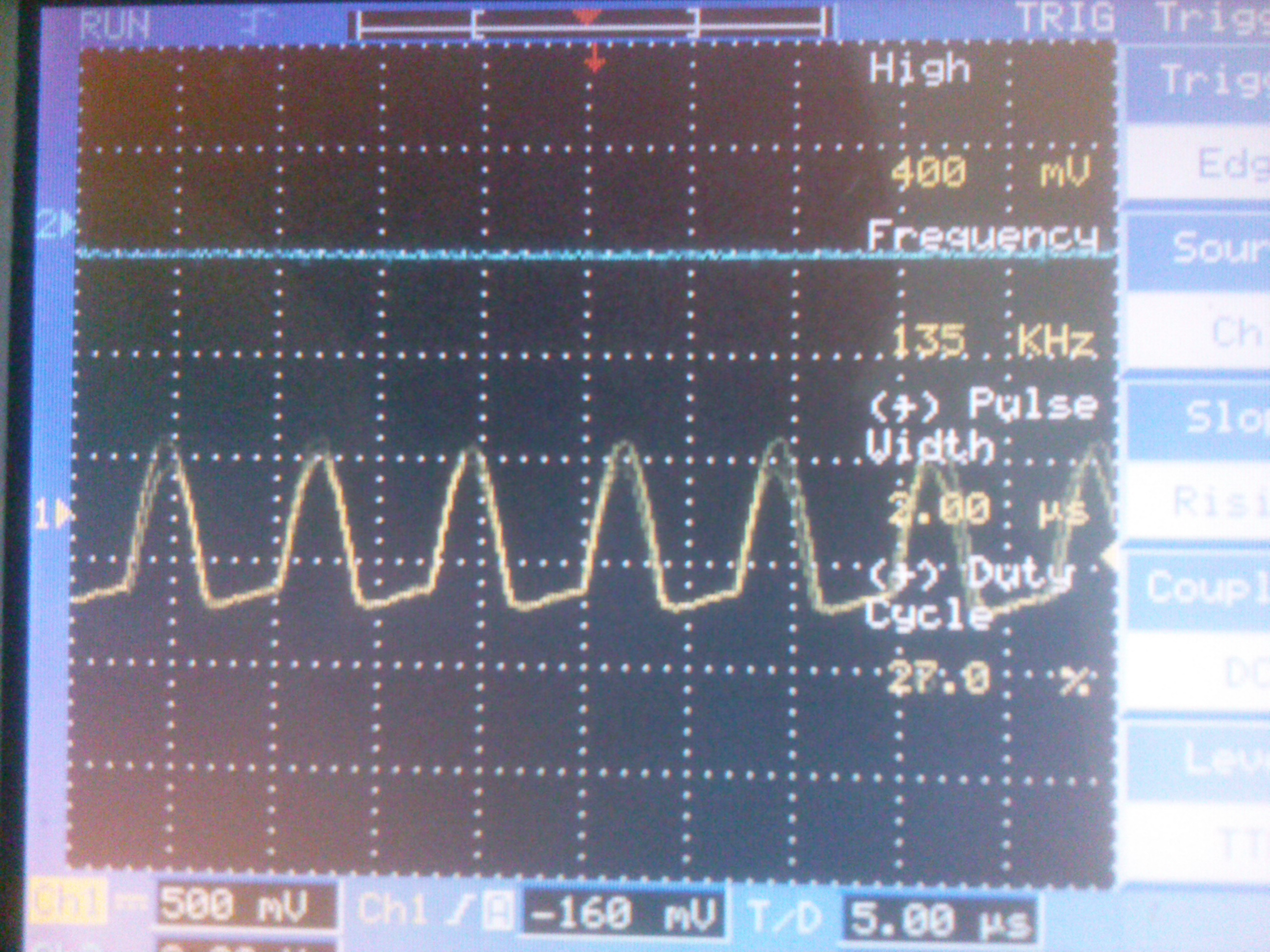

    We tested with 4,7nF, 10nF and 20nF capacitors for the CFB pin - there were no oscillations.
    After that we soldered a 120pF capacitor and the result on the CFB pin was the following:
    On both LDC IC1 and LDC IC2 (120pF CFB capacitor):

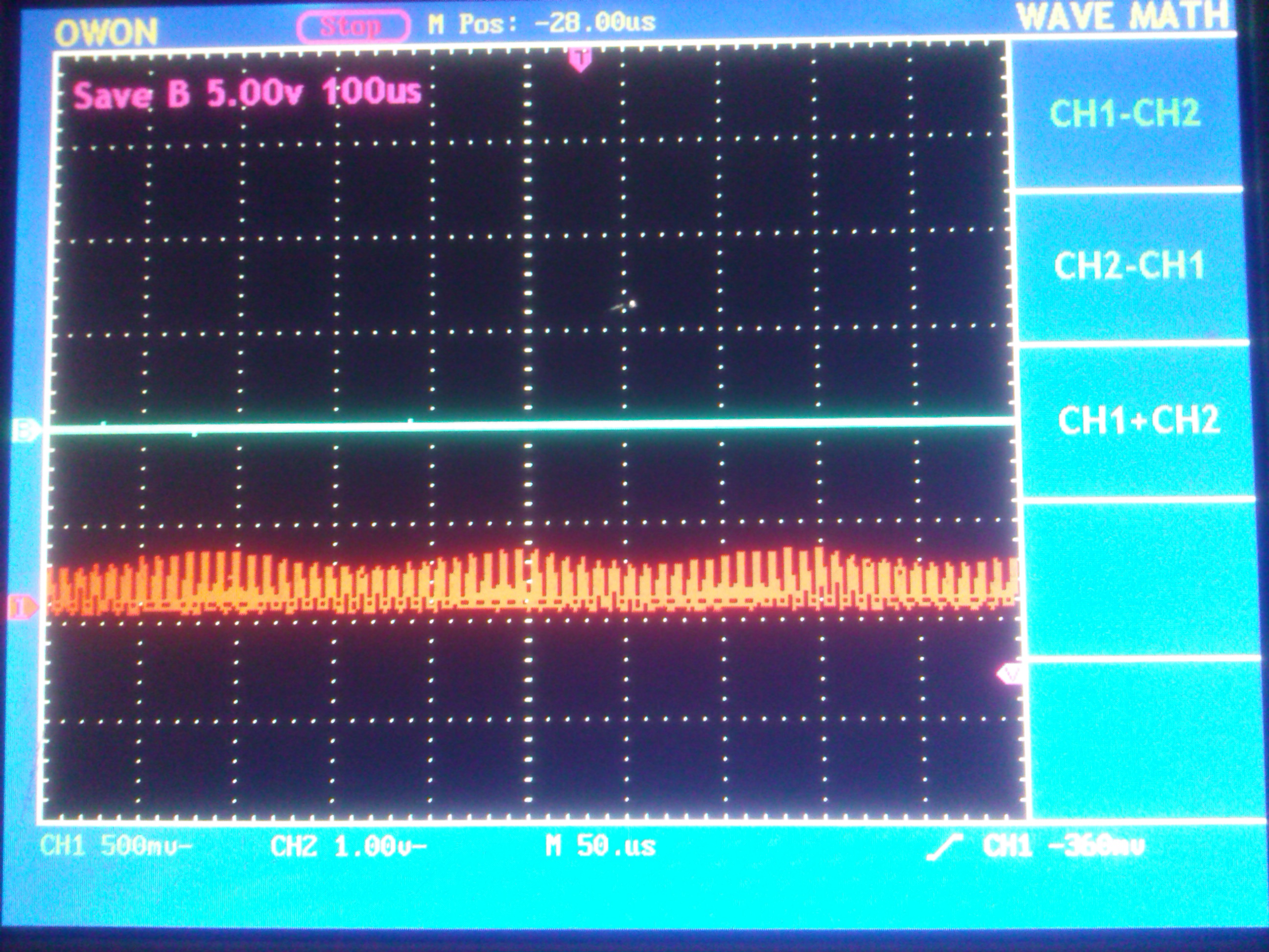

    Then we removed the INx capacitors and tested with another one - one and the same INx capacitor and one and the same coil for both of the LDCs. Here is what happened to the INA pin amplitude, keeping the CFB capacitors at the value of 120pF:
    *Refer to the update - my next post!
    LDC IC1:
    LDC IC2:
    The first IC1 is still problematic - it reads zeroes in the lower ranges, mentioned in a previous post.
    The second one seems to work fine (or least far better than IC1)....
  • Update:
    According to the last to shots, where I mention the amplitude issue - I measured the INx pins with a 1k resistor in series - it seems fine now (looks like the first screenshots, with amplitude leveling between 1-3V )
  • Hello Varban,
    The amplitude in the 1st shot is too low - it has to go all they way to 4V, if such oscillation amplitude is chosen in the register
    2nd and 3rd screenshots look good!
    If you cannot get the amplitude to 4V (The Rp of the system is too low) you can try to decrease oscillation amplitude (Reg. 4)
  • Hello Evgeny,
    Thank you for the information! I have figured out how to adjust the filter capacitors until I get the right oscillation.
