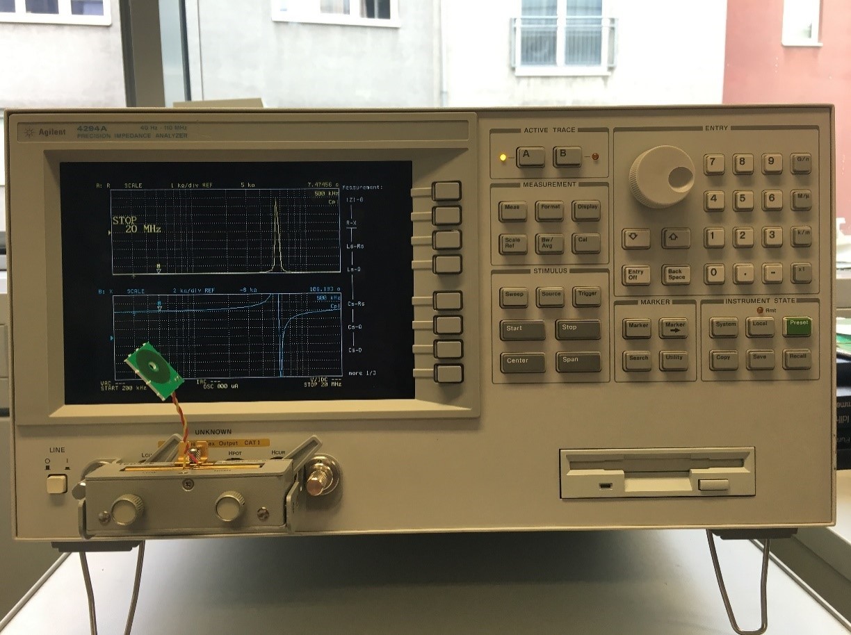

  • Hello Luke,
    i am not sure about the RPmin.
    This was my steps to measure the Rp:
    1.) Mesure the Rp and L with an Impedance Analyzer as described in SNOA936.
    I Measured that without any capacity ... is that right?
    2.) I got this result:
    As you can see the resonance frequency of the coil is about 8,3 MHz and i want to operate the coil with 1MHz.
    3.) So i measured the Rs @ 1MHz (5,74998 Ohm)  and  Ls @ 1MHz (21,3158µH) and use the formula:
    and the result for Rp is 3,12k Ohm
    4.) Now i use a Capacity with 1,2nF for operating @ 1MHz
    5.) So I set the Rpmin to 3kOhm in LHR - Mode.
    6.) And measured the Voltage with an Oscilloscope and get following result:
    Distance to an aluminium target:
    Distance to target
    Vpp
    10mm
    1,3V
    8mm
    1,28V
    6mm
    1,24V
    4mm
    1,15V
    2mm
    0,86V
    1mm
    0,52V
    0,7mm
    0,4V
    0,6mm
    0,3V
    0,5mm
    0,25V
    Is the setting right for the Rpmin?
    Best Regards Jan
  • Hi Jan,
    When a conductive target approaches a coil, its inductance drops, and Rs increases.
    Can you measure coil parameters with the target at 0.5mm (if that's your intended minimum distance between the coil and target)?
    Then you can calculate RpMIN which will be able to drive the coil under full load (target at closest proximity)
    Please also note, that your oscillation frequency will increase as the target approaches the coil: the cap is fixed while L drops.!
