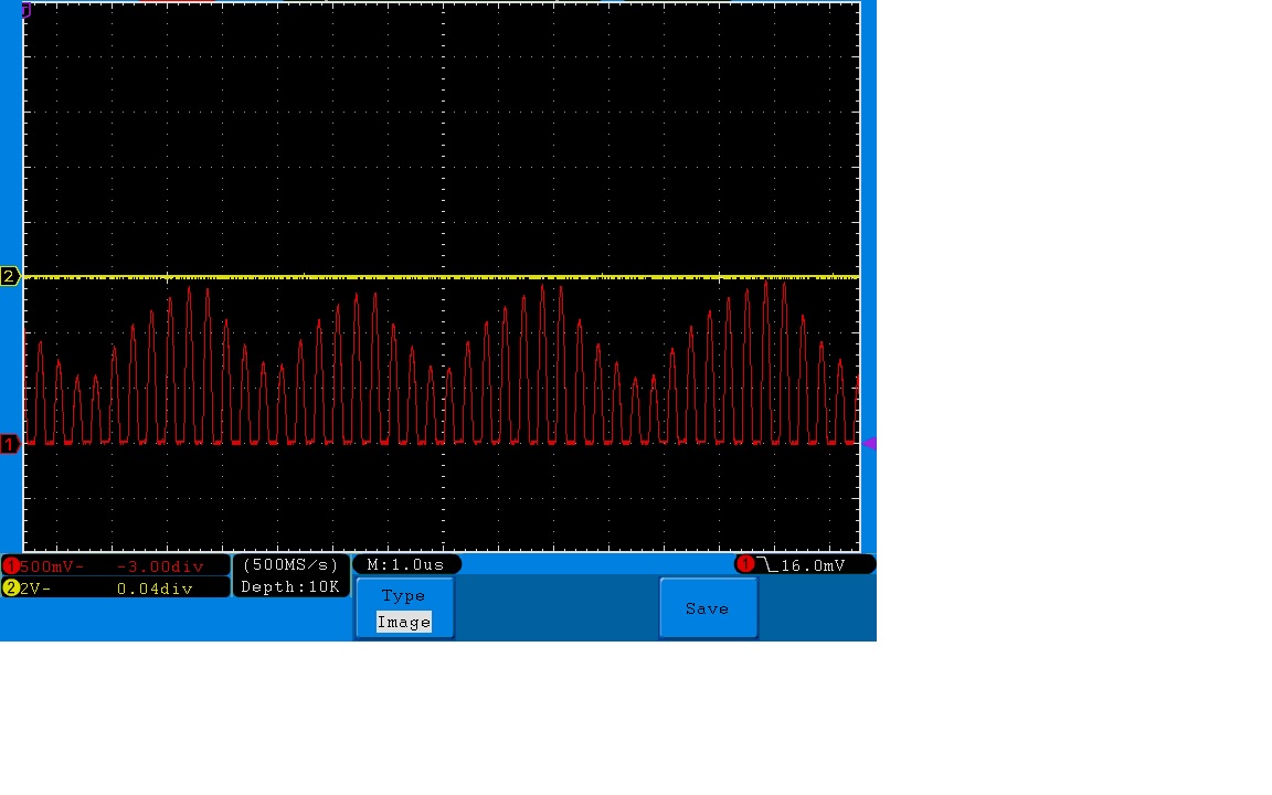

    I have measured the INA signal and attached the screenshot (INA.bmp). The channel 1 in red is the INA signal.

  • Hi Erwin,
    Please clarify - you scope trace looks like the sensor amplitude is only 350mV; is that correct? If so, then the sensor amplitude is too low. Try changing the RPMIN value from 0x33 to 0x3F.
    Also, can you provide a scopeshot which shows around 50 cycles of the sensor signal?

    and now to INTB seems to work. Please find attached the INA signal now with up to 1.5V amplitude; does this look OK?
    Erwin
  • Hello Erwin,
    Yes, that is the expected signal. The issue you encountered was due to the RPMIN being higher than the sensor's Rp. In that situation, the sensor amplitude is too low.
