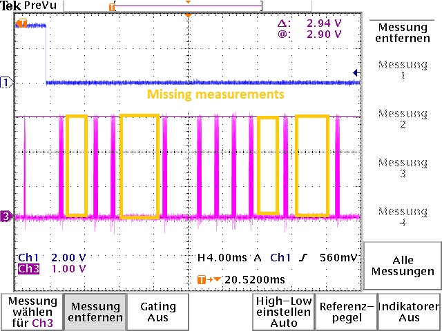

Dear TI Team,
We´re currently developing on an application using the TI LDC1614 as proximity sensor, whereas the LDC is operated in four channel - sequential mode using a measurement frequency between 1.5 and 2MHz. A highly precise external 40MHz clock is used as reference clock. The LDCs config reads as follows:
CONFIG = 0xDE01
MUX_CONFIG = 0xC20D
R_COUNT = 2400  and R_SETTLE = 96         (same setting applies for all 4 channels -> yields an measurement update frequency of 250Hz)
FIN_DIVIDER = 1, F_REF_DIVIDER = 1          (same setting applies for all 4 channels)
I_DRIVE_CURRENT = 31
Applying those settings yields an analog signal amplitude of approx. 1.6 - 1.7V, what actual complies with the chip requirements. However, the LDC1614 seems sometimes (completely arbitrary behavior) not to be able to excite the oscillation circuit on one or more of the LDC channels. The following figure shows the phenomenon.
The yellow graph indicates a reference signal, the blue graph shows the signal of the LDCs CH0. Obviously the LDC sometimes misses to excite the resonance circuit.
In the course of dissolving the issue we tried to lower the content of the I_DRIVE_CURRENT register (e.g. 28)  -> the signal amplitude drops to ~1.3V and the problem completely vanishes. As we´re not really able to understand this phenomenon we would highly appreciate your expertise related to the problem.

  • Hi Luke,
    Thank´s a lot for your detailed answer! Indeed we used the LDC somewhere around the edge of the allowable Rp with our setup. With a lower I_DRIVE value we slightly exceeded the value of 1kOhm in accordance with the formula provided.
    Thus our next intention was to increase the measurement frequency to get a Rp significantly larger 1kOhm in order to obtain a kind of safety margin. To do so we kept our LDC register config and just changed the capacitors within the resonant circuits of the LDC1614 which lead us to a measurement frequency of about 3.17 MHz.
    With an I_DRIVE setting of 31 and a measured Vp of ~2.94V the problem again occured, though we obtain a calculated Rp of 1,477 kOhm.
    (The pink graph shows the analog signal of an affected LDC channel, the orange boxes indicate one or several dropped out measurements)
    In the following we again tried to lower the I_DRIVE setting what again made the phenomenon vanish. Two of the tested I_DRIVE settings are shown below:
    1.
    I_DRIVE = 29 lead to a Vp of ~2.50V and to a calculated Rp of 1,67kOhm, this setup worked properly, no dropouts occured.
    2.
    I_DRIVE = 26 lead to a Vp of ~1.70V, to a calculated Rp of 1,75kOhm, this setup worked also properly and again no dropouts occured.
    So also in compliance with the specs, means for us keeping Rp > 1kOhm the chip is obviously not always able to drive the circuit. What seems a little strange, is that the problem more likely shows with a high or even just the highest I_DRIVE setting though more current should be beneficial to excite the resonant circuit.
    John
  • Hello John,
    Keep in mind that we recommend to operate the sensor below 1.8V. If you are going beyond 2V then you start to activate the ESD circuitry of the inputs, so if you're getting 2.94V then this is well beyond the allowable level and would explain the behavior. You can refer to the following document which provides more information on setting the drive current: www.ti.com/.../SNOA950
    Luke
  • Hi Luke,
    thank´s a lot for your advice!! Staying below 2Vp the problem did not occur any more.
    Thus the current issue can from our point of view be marked as resolved.
