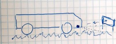

    In this particular case, the sensor is installed in the moving vehicle, not on an external fixed target. The goal is to measure "my own speed". Of course, "my own speed" is the same as the wall coming against me, but a few mechanical details concern me:
    - There is hardly a reference that is perpendicular to the movement (such as the wall) - more often, the floor is the only thing around
    - On such environments, the "floor" is all sorts of rocks, bumps and what-not (which is probably more convenient to capture reflections, albeit with irregular response angles).
    Here's a Picasso-quality sketch to make things more visual.
    As an initial step here, we'd like to determine which ev board, antennas/sensors and whatever would be needed for a test. Also, a rough "speed accuracy" expectation would be most welcome. For the data output, we can easily integrate the outputs into our TM4C based measurement systems, so once we get "the sensor values", we'll (probably) easily do the rest.

    Ability to distinguish between distance from object in front vs ground:
    Ability to measure perpendicular reference for distance:
    mmWave Devices have multiple Transmit receive antennas which allow objects to be distinguished in 3D space. For eg. IWR1443BOOST EVM boards can enable object detection in Azimuth and Elevation  and hence separate out the objects in these dimensions.
    This can be used to determine distance of objects which are various angles to the mmWave Sensor and help identify the distance from object of interest.
    Would this be an add on mounted on the vehicle?
    Is this expected to be operated in controlled environment like indoor plant or enclosed perimeter?
    For evaluation an IWR1443BOOST would be a suitable board to get your hands. The Out of Box demo for this board displays objects in 2D space as well as 3D space. This can allow you to see how the scene gets represented in terms of detected objects.
    Furthermore the demo can be configured for various distance/speed and detection sensitivity by modifying parameters available for demo.
