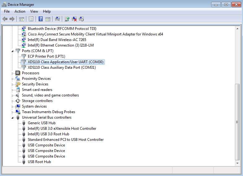

I have AR1443EVM (evaluation board) with XAR1243 (which may be a sample device). This setup works with mmw_demo software, which might indicate that USB driver setup on my computer is complete.
To use the eval board with Radar Studio in Development Mode, I used the same setup as that used in mmw_demo experiment and found error messages in Radar Studio (shown below): No. of Devices Detected: 0, and Setting SOP Mode to Mode 2 (Development) returned "Radar devices not selected!"
I also erased SFLASH of the eval board as instructed and found the same issue.
