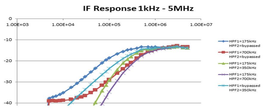

  • Hello Quintal,
    Thanks for your reply!
    Low pass filter provides filtering for the 1st nyquist zone sampling of the ADC, high pass filter is used to attenuate the close in (radome reflection) radar signal.
    If ramp slope=20MHz/us, cutoff frequency of the high pass filter is 100kHz, then the round-trip time=100kHz/(20MHz/us)=5e-9s, that is to say, the minimum detection range=0.5*3e8*5e-9=75cm
    So, if the cutoff frequency of the high pass filter is 100kHz, the radar cannot detect objects within 75cm?
    BTW, could you please provide the detailed cutoff frequencies of the high pass filter?
    Thanks a lot!
    David
  • Hello David,
    the High pass filter example is shown in the following attachment.   Note: there are 2 filters to get the desired attenuation.   The light green is the least intenal filter setting.   You can still detect close in objects, if you have enough range resolution, signal level, and SNR for object detection.
    Joe Quintal
