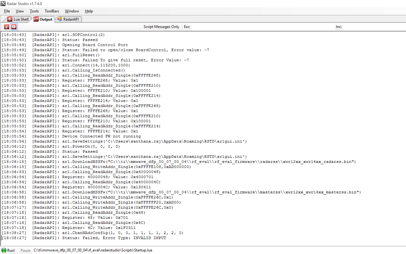

I am trying to connect AWR1443 +mmWave DevPack+TSW1400 and configure them through Radar Studio 1.7.4.0.
I am able to connect to the board. But any of the configuration commands return a status invalid error in output window.
The radar studio screenshots are as below:
Connection tab:

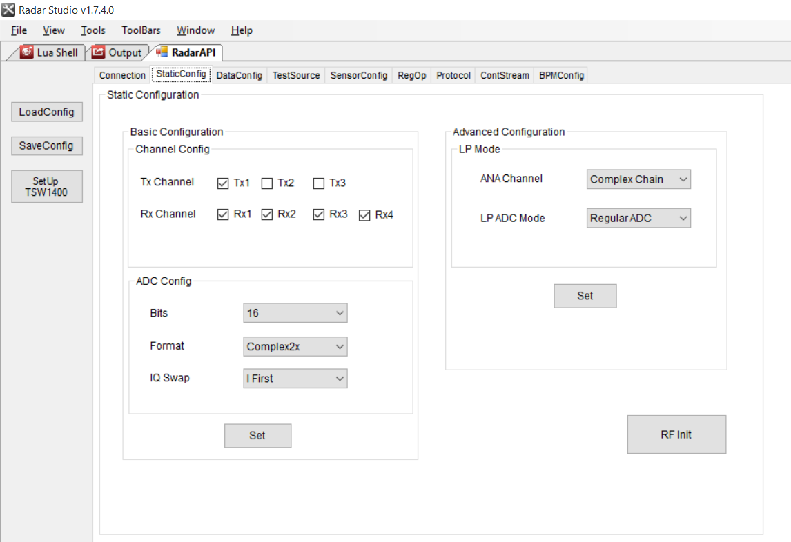

Static Config tab:
When I click on Set button here, it throws an error on output page.
The error in output tab is:

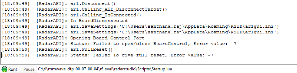

One could notice that there is some error at the start with reset. the screenshot of error when I click on reset button is as below:
I hope these information are enough to debug the issue. Kindly let me know what else can be done to solve this. I am also facing problem to use AWR1642 with this, which I am posting in a separate thread.

  • Santhana,

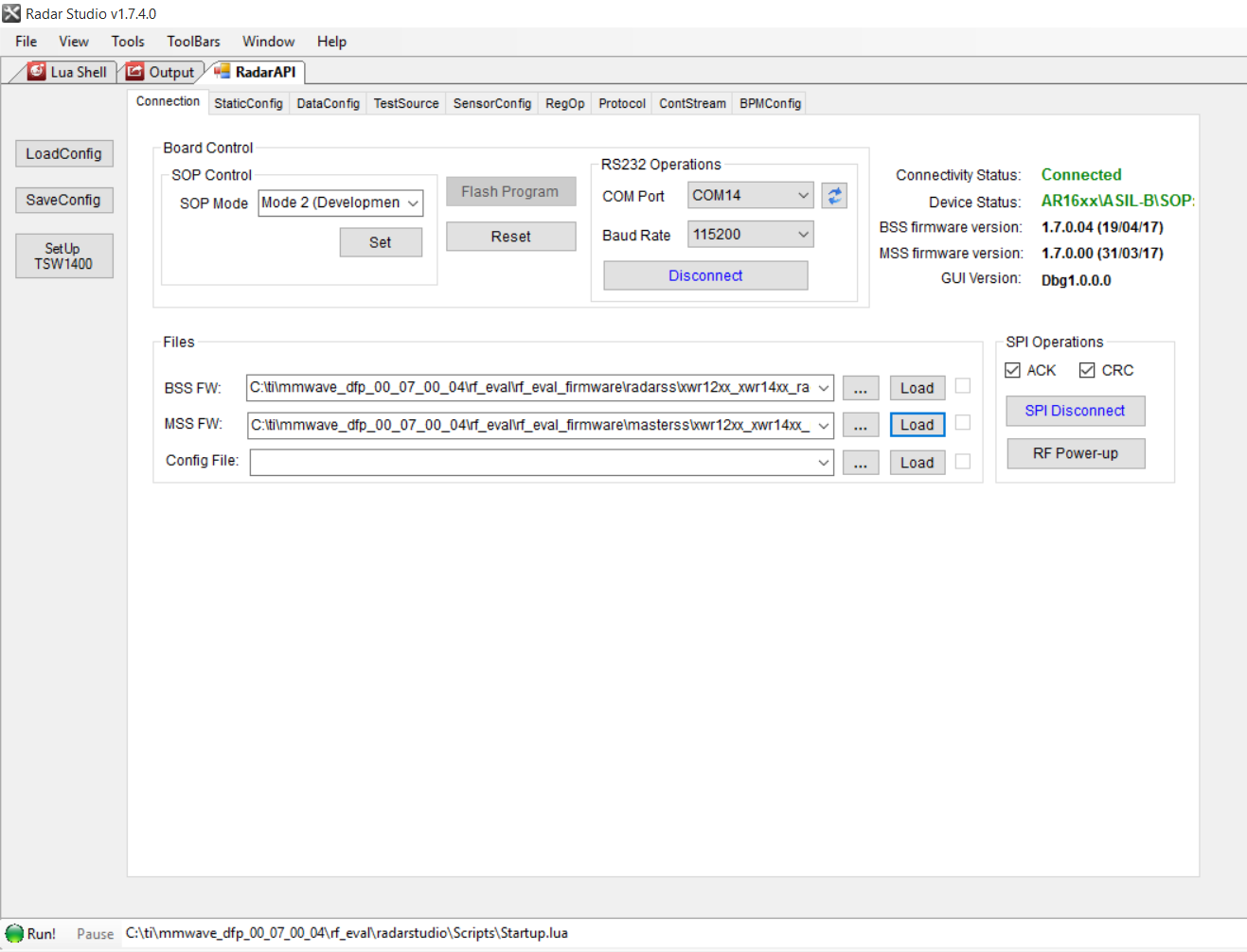

    The device is showing up as a AR16xx in the snapshot you sent . Are you sure you have connected AWR1443?
    -Raghu
  • HI Raghu,
    Yes, I Have also noticed that. But I have connected AWR1443 only.
    I thought it is normal.
    IF that is an issue, I suspect it is an firmware issue. Any idea where to debug?
    Thanks in advance,
    Santhana Raj

    On connection to RS232 (3c of your steps), the device status shows AWR16xx instead of AWR14xx.
    Any help??
    Santhana Raj
  • Santhana,
    Looking at all the RadarStudio snapshot and also your setup it is clear that you are using mix and match of the older Radar Studio with newer firmware etc.
    Below is the snapshot of the RadarStudio v1.7.4.0 in the latest MMWAVE-DFP which shows the FTDI, RS232, SPI connectivity status. Your snapshots of the RadarStudio do not show it indicating that you are not using the latest tools in the MMWAVE-DFP version "00.07.00.04".
    Please download the MMWAVE-DFP and use the latest RadarStudio in that DFP .
    Raghu
