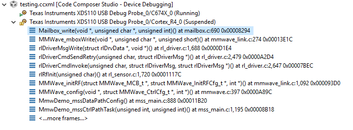

  • Hi Raghu,
    The error appears to occur during initialization of the RF subsystem. When the init message is being set, the mailbox tries to trigger an interrupt by writing to a register it looks like? At line 690 in mailbox.c
        ((driver->hwCfg)->baseLocalToRemote.reg)->INT_TRIG = CSL_FINSR (((driver->hwCfg)->baseLocalToRemote.reg)->INT_TRIG, 0U, 0U, 1U);
    Debugging through, this is where the error actually occurs. Unfortunately, this error also causes the debugger to disconnect.
    I've attached my stack trace from just before the error occurs as well.
    Any progress on your end? Any other information I can provide that might be helpful?
    David
  • David,
    The crash and error message shown in the Linux ROS message capture you sent are typically seen when the EVM does not have sufficient power. The EVM user guide specifies a 5 Volt power supply that can supply at least 2.5 Amps. Many phone/device USB chargers and computer USB ports only supply around 1 Amp and will cause the crash seen. If you are using a computer USB port or a charger/adapter that lists a current less than 2.5A (typically printed somewhere on the adapter), then you will need to change it out for a 5V power supply that can supply at least 2.5A. If your current power supply meets the requirements, you may also want to try swapping it out with a different power supply in case the one being used has an issue.
    Please mark the thread as answered if the issue is resolved or reply if more support is required.
    John
  • ...2 weeks of digging through code, and that fixes it immediately. Thanks John!
