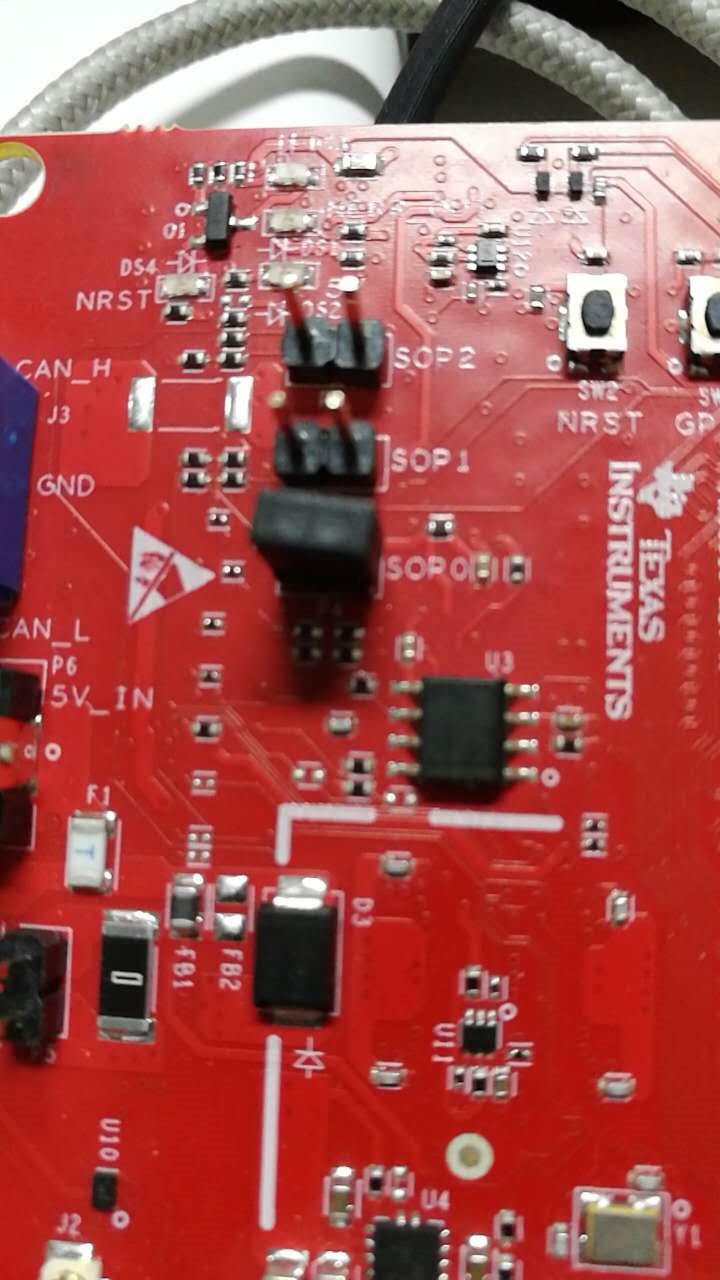

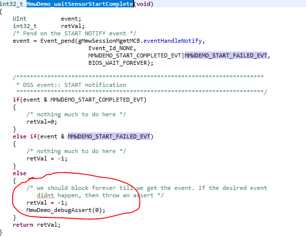

AWR1443 can be load throuth  the serial port  and  the nerror_out  pin is high indicat that there is no error happend 。but when the sop combinations are set  001 mode (functional mode ),the device cannot work ,and the nerror_out  pin is low ,and push the reset pin ,then the nerror_out is high ,but the device cannot work still 。my qspi flash is S25FL116K0XMFB041
