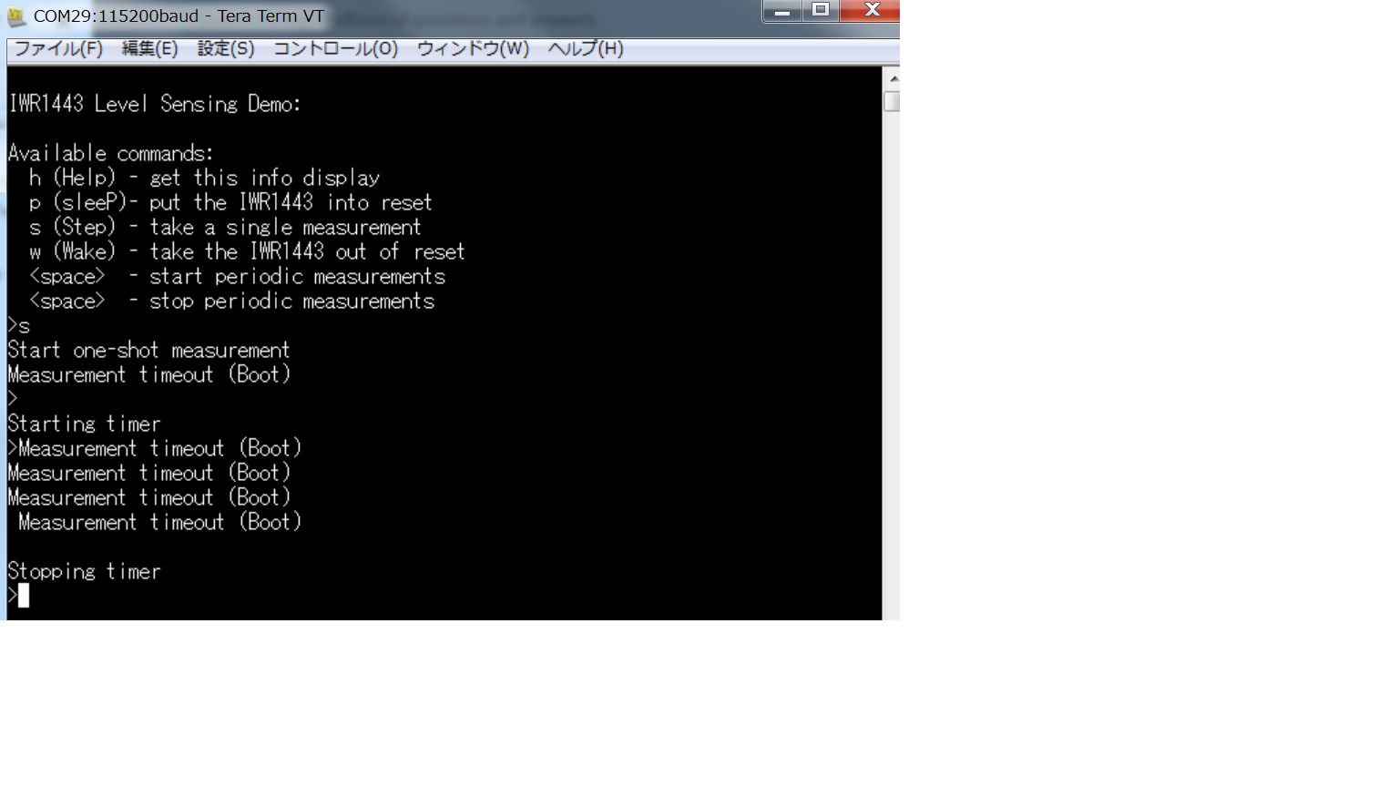

I try to use TIDEP-0091(IWR1443BOOST and MSP432). Both boards has been flashed, but output of timing measurement to UART doesn't work.
As shown below, "measurement timeout" is displayed on Tera term.
Could you tell me what is going wrong?

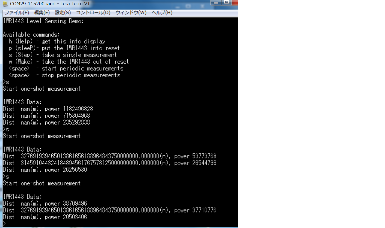

  • Thank your reply, Dave
    I tried running pre-built binaries, and a figure shown below is displayed on TeraTerm.
    The number representing the distance is very large,
    As time goes by, the screen gets settled. What is going wrong in the modified hardware?
    Then,I rebuilded both IWR1443 and MSP432 executables with the uncommented REPORT_IR14_TIME_MEASUREMENTS.
    However, "measurement timeout(Boot)" is displayed on Tera term.
    Shouhei
  • Yes, that output is obviously wrong.  I have not seen it look like that.  First, please check that you are using the exact versions of the tools specified on slide 5 (Pre-requisites) of the Getting Started guide.  Use version 1.40 of the MSP432 SimpleLink, do not use version 1.60.  If you have 1.60 installed, uninstall it, install 1.40, then restart CCS and go into the MSP432's project properties and make sure 1.40 is selected.  Do a clean + build.
    Another possibility is that your resistors are not correctly installed.  Please make sure they are on the correct pads, and that no solder is touching adjacent pads.  If you don't see the IWR1443's LEDs turn on and off when you do a single shot, then you know that R102 is not present.
    You can run the demo with no resistors installed (or ignoring the resistors that are installed).  If you follow the instructions in section 5.2 of the Getting Started guide, you can run a single measurement in CCS and see what the measurements are that will be sent to the MSP432 over SPI. This will tell you if the problem is in the 1443, or in the communication with MSP432.

  • Thank your reply,Dave.
    I uninstalled 1.6-version and used 1.40-version of the MSP432, but "Measurement timeout(boot)"
    was displayed.
    I can see the IWR1443's LEDs turn on and off when I do a single shot, and so R102 is present.
    I think R164 is present,too.
