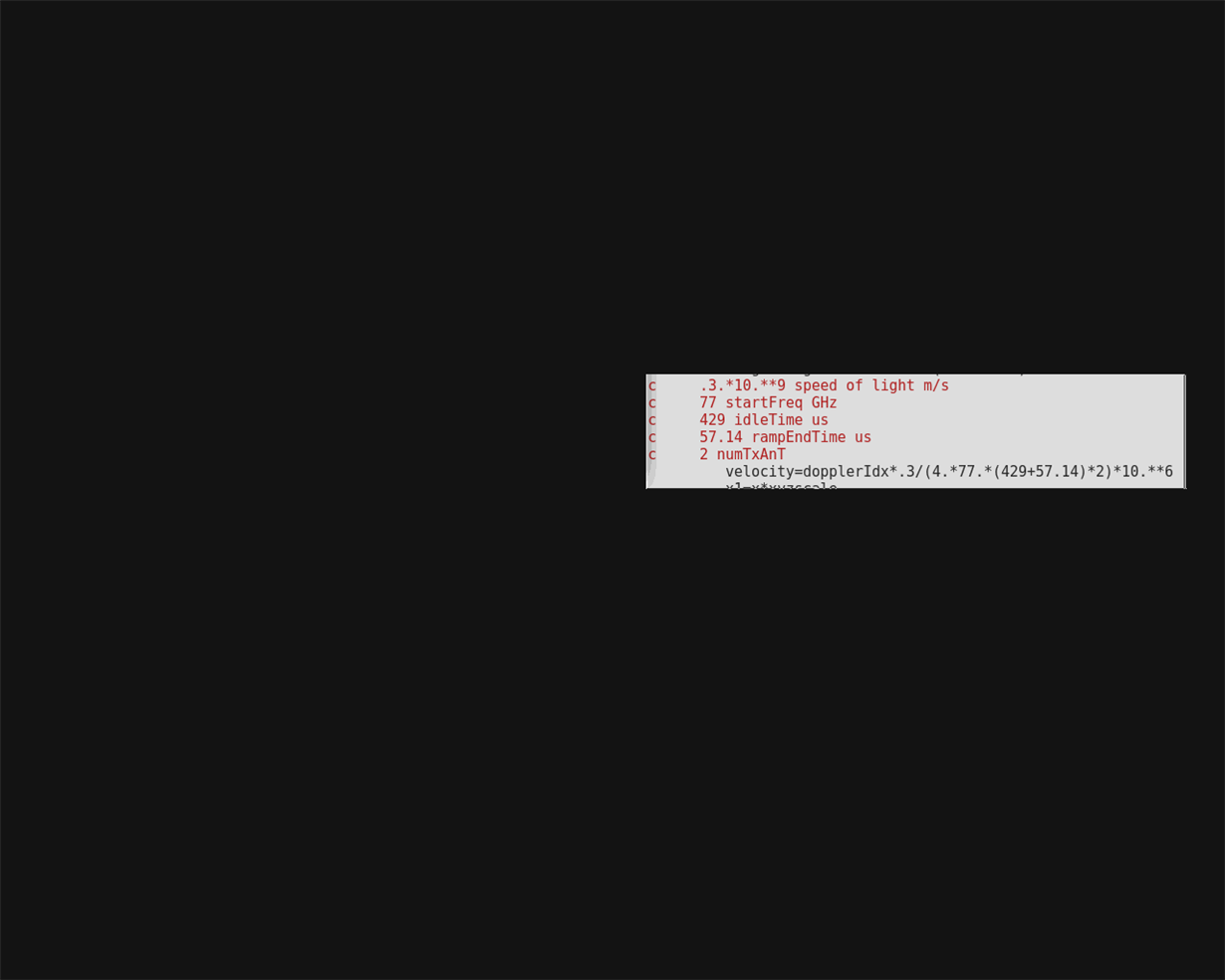

c. I am having difficulties reproducing the velocities that the gui
  is producing. The image conversion.gif illustrates what the code is
  using. My measurement object is a corner reflecting moving on a
  track at a known fixed rate. I observe the velocity value generated
  by the gui and I can not generate this value. My code is shown in
  code.gif and is functionally the same as in conversion.gif.  My
  velocity values appear to have a resolution of 1 mps when scaled but
  your velocity resolution equation indicates that the resolution
  should be much finer. Thoughts?

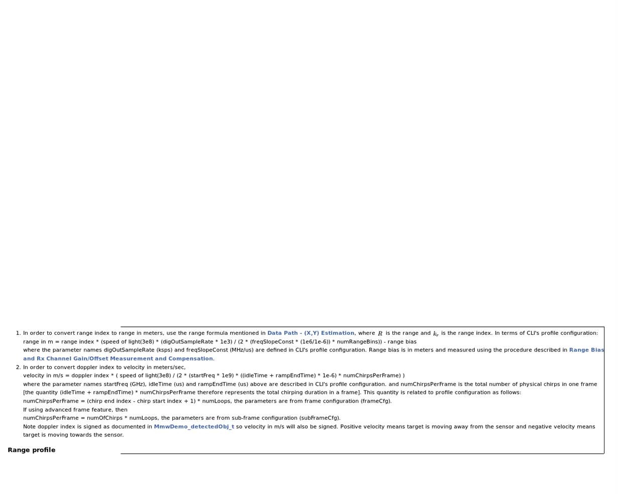

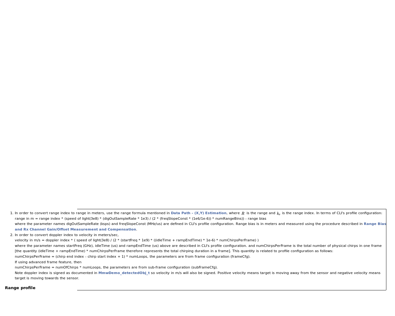

4. The expression provided in
mmwave_sdk_02_00_00_04/packages/ti/demo/xwr16xx/mmw/docs/doxygen/html/index.html
for velocity given dopplerIdx must be a mistake.  I would say that
this expression yields the velocity resolution and not the velocity as
suggested in conversion.gif. Is this correct? Please see
conversion.gif and index.gif.

  • Hi Allen,
    Sorry for the delay, the velocity conversion formula is correct and it calculates the velocity (not velocity resolution) as explained below:
    Consider for simplicity that a chirp is designed with maximum velocity of 16 m/s and a velocity resolution of 1 m/s. We'll need at least a 16 pt. doppler FFT and each FFT index will represent 1 m/s.
    Now, looking at the conversion formula given in the demo documentation:
    velocity in m/s = doppler index * ( speed of light(3e8) / (2 * (startFreq * 1e9) * ((idleTime + rampEndTime) * 1e-6) * numChirpsPerFrame) )
    The term highlighted in yellow can be written as c/2 * v * Tf, (where c = speed of light, v = start frequency, and Tf = Total active frame time (chirping part)
    As c/v = Lambda, the highlighted term can be further reduced to Lambda/(2 * Tf), which is the formula for velocity resolution and in our example represents 1 m/s.
    When multiplied by the doppler index, say 7, this becomes 7 m/s i.e. the actual velocity.
    Please let me know if you need further support.
    -NItin

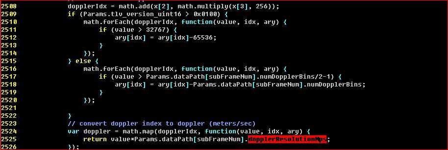

  • Hi Allen,
    The actual Doppler is computed using this dopplerResolutionMps value in function processDetectedPoints as shown below:
                // convert doppler index to doppler (meters/sec)
                var doppler = math.map(dopplerIdx, function(value, idx, ary) {
                    return value*Params.dataPath[subFrameNum].dopplerResolutionMps;
    Hope the above clarifies the velocity computation in the SDK demo.
    -Nitin
  • Hi Nitin,
    I have been resolving my issues. Based upon the default values for the profile.cfg file, I have mostly addressed my questions. The demo sdk provides data for the maximum range, range resolution, maximum velocity and velocity resolution on the "plot screen". Application report swra553 (programming chirp parameters in ti radar devices) provides equations for these values (pages 3 and 4). I agree with these equations but I can not recover the same value for the maximum velocity that the sdk provides. I am a factor of 2 too large.
    Max velocity is lambda/(4T_c)
    and
    velocity resolution is lambda/(2NT_c).
    From the profile.fig
    profileCfg 0 77 429 7 57.14 0 0 70 1 240 4884 0 0 30
    frameCfg 0 1 16 0 100 1 0
    lambda =.3/77
    T_c=idle_Time+rampEndTime=429+57.14 (us)
    N=numChirpsPerFrame=32 (two transmit antennas so 2*16)
    I get for max velocity a value of 2 m/s while the sdk indicates 1m/s. Can you please indicate my error? I believe the number of doppler bins is 32 so the max velocity should be N/2*velocity resolution.
    Please confirm that the number of range bins in this case is 240 too. By the same reasoning, the maximum range distance should by (240/2)*range resolution. Correct?

  • Hi Allen,
    Regarding velocity, if you're using a MIMO configuration i.e. with 2 transmitters, the effective chirp time Tc is doubled since with TDM MIMO, each transmitter chirps alternatively. This halves the maximum velocity so you need to apply the same factor in your own calculation as well. You can refer to the following threads for more details:
    e2e.ti.com/.../2337141
    e2e.ti.com/.../674256
    The peak values is a linear value and it represents the FFT magnitude. Please search the forum for peak value and you should be able to find quite a few threads on this subject.
    -Nitin
