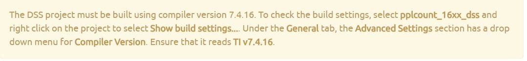

  • Hi Mason,
    To install the correct compiler:
    1) In Code Composer Studio, select help->Install Code Generation Compiler Tools
    2) This will bring up a list of all Compilers available. Make sure to deselect "Show only the latest versions of software"
    Select C6000 7.4.16 and install it.
    From your pictures, it looks like you have successfully imported the project. What is the issue with import?
    Justin

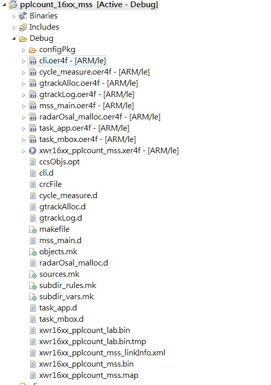

  • Not shown in the Debug2 file
    Xwr16xx_pplcount_dss.bin
    Xwr16xx_pplcount_dss.xe674
    And
    Xwr16xx_pplcount_mss.bin
    Xwr16xx_pplcount_mss.xer4f
    Xwr16xx_pplcount_lab.bin these options
    So importing build dss.mss is not successful
    It should be2e.ti.com/.../2636953 shown to you in the picture.
    I will try again a few more times,
    Thank you for your patience.
  • These will appear after you compile the demo. After compiling DSS, you will be able to find:
    xwr16xx_pplcount_dss.bin
    xwr16xx_pplcount_dss.xe674
    After compiling MSS, you will find:
    xwr16xx_pplcount_mss.bin
    xwr16xx_pplcount_mss.xer4f
    xwr16xx_pplcount_lab.bin
    Justin

  • Hi Justin
    I have installed TI v7.4.16 version
    Still the same can not be found in the Debug folder
    And
    Only these items, as shown
  • Is the Rebulid file unsuccessful?
    Buildfile generation error occurred..
    Product 'com.ti.mmwave_industrial_toolbox' v2.3.0 is not currently installed and no compatible version is available. Please install this product or a compatible version.
    Build stopped..
    I think this is the error expressed by this message, which can not be imported.
    But I already have mmwave_industrial_toolbox' v2.3.0 installed.
    A compatible version means?

  • Hi Mason,
    When you press rebuild, the compiler first tries to delete all the old .bin and object files. Because you have already cleaned, the compiler will show this error. However, this will not cause the build to fail.  I have encountered the same error and had the software build successfully.
    If you are seeing "Target main-build not remade because of errors" then the build is failing. Statements that cause the build to fail will be highlighted in red as well.
    Do you have the c6000 7.4.16 version of the compiler installed? This is required for a successful build.
    Justin
  • YES . I installed it c6000 7.4.16 .

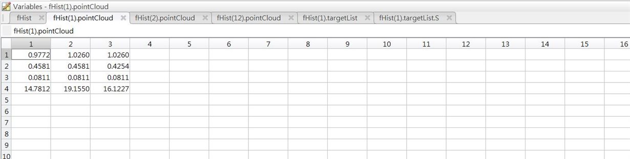

    If there is no component success, is the test data of Matlab directly correct?
  • Point cloud has three items, what do they represent? Speed Distance?
  • Hi Mason,
    Each column is a point: Data is by row:
    Range (meters)
    Angle (radians)
    Velocity (meters)
    SNR
    Justin

  • Dear Justin
    What do these items mean?
    DONE?
    Point cloud 4X7 single
    What does 4 stand for?
    7 is the signal?
    Benchmark, starting point Why is the difference so big?
    What are these units?
    Thank you

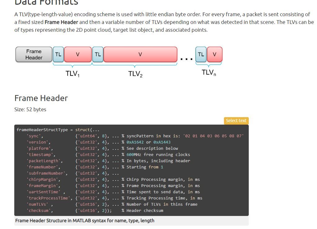

  • Hi Mason,
    Regarding:
    timestamp, start, benchmarks, done:
    These are metrics used by the software designers to benchmark the software. They were determining time in ms to process the result. Each frame lasts 50 ms, so a difference of 3 or 4 ms is fine.
    You will mostly be interested in the Point Cloud, target list, and target index.
    Point cloud contains data for each point. It will always be 4 rows by N columns, where N is the number of points. So in the first row from your example, Point Cloud is 4x7 as there are 7 points.
    Target list contains information about the targets. Device will never send more than 20 in a frame. There is one target for each person. See my previous post and the User's guide for information about the data structure. For location, you will be interested in S[1], which is the X coordinate, and S[2], which is the Y coordinate. Assume the IWR1642 is at (0, 0).
    Finally the target index relates each point to a tracked object (target). Target list and target index are sent 1 frame after point cloud is sent, so target list[frame m] will have values for point cloud[frame m-1]. See the user's guide for an explanation of the target index data structure.
