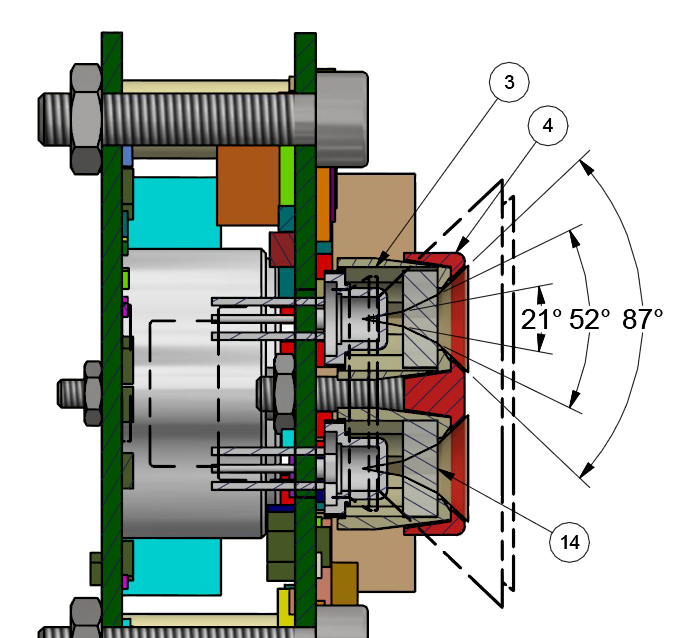

  • I have more question about construction of diffusers and diffusers itself.
    In 15345 Assembly, CDK-Illum.pdf there is a information about divergence angles of laser diode's light beam.
    I made a screenshot of the interesting area from this pdf
    If you see, you (creator of this file, TI) drew how beam from laser diode is going from laser then through first surface of diffuser (first refraction) and change its angle from 21 degree to 52, then change its angle from 52 to 87 degree by passing through second surface of diffuser.
    Here is the question#1. How did you find/get/count this angles? What is the formula to get this information?
    Moreover, diffusers from RPC Photonics is not just a piece of glass it has more complex structure. In their Fact-Sheet there is information like that:
    Divergence angle 81.7º
    Index of refraction 1.56 @ 633nm.
    .. and I don't understand what they have meant.
    Q#2: Do you understand what does this numbers mean?
  • Best to consult RPC directly since it is their data sheet.  But it looks like divergence angle is angle at which light exits the diffuser, while index of refraction impacts angle the angle at which light propagate within the diffuser.
