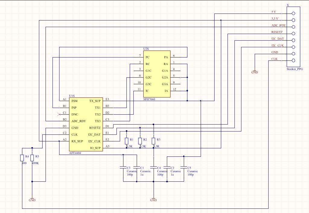

AFE4404: Using the AFE4404 with an Arduino MEGA
Part Number: AFE4404
I tried to set up the AFE4404 with the source code I got from TI for their AFE4404EVM software. Since I am not using the same setup the evaluation modul does, I am now experiencing some issues and would like to ask if someone could help me.
I am using an Arduino MEGA to control the AFE4404 in combination with Osrams SFH 7060. I do not have much time left for my diploma thesis which led me to only use one of the SFH 7060´s LED´s. At first I tried to simply turn the LED on via I2C but did not get it to work. The program stops at the first try to send something through the I2C lines.
I then tried to simply see if the AFE is responding to an I2C device with a prebuild program which only identifys connected I2C devices. This program worked with other devices I got but doesn´t if I connect my board with the AFE on it. It seems like it blocks every traffic giong through the I2C lines.
I got the program from Nick Gammon at: http://www.gammon.com.au/i2c
When setting up my program, I left out a lot from the original source code due to my very limited usage of the AFE capabilities. Can you tell me if I missed something essential regardless of how many of the AFE functions I´m using?
I attached my personal source code and the circuit diagram of my board so you can get an idea of what I´m doing.
I would really appreciate some help.
Simon

  • Hi Simon,
    I don't see the schematics.
    Just to narrow down the problem, can you please provide following information.
    1) Is AFE4404  giving ACK after you send salve address for any I2C operation? If not what is the slave address? Can you share analog waveform for the I2C_CLK and I2C_DATA pins during any I2C operation.
    2) Assuming AFE4404 gives ACK, can you measure voltage at INP pin of AFE after I2C_Write(0x23, 0x01)? Also measure before this I2C write operation.
    Prabin
  •  I´m sorry for not checking my post. I hope the schematics are attached this time. I did not get anything working on the AFE because the I2C communication stoped right at the first try to send something. I am going to get some analog waveforms for the I2C lines in the next days and will share them with you afterwards.
  • Hi Prabin,
    I regret to say that I did not manage to get proper waveforms to share yet. I´m working on it.
    I produced one more board with an AFE on it and modified my source code a little bit. The I2C is now working and doesnt stop at the first try to communicate with the AFE. My problem now is that if I run my program to simply detect the slave address, it prints out 3 addresses for the AFE and none of them is the fixed AFE slave address.
    Further experiments led to the same outcome as last time which tells me I destroyed the AFE. I am going to produce some more boards for testing.
    Does anyone have an idea why I´m getting multiple wrong addresses? My next try will be to vary the pullup resistors on both I2C lines.
    Simon
  • Hi Simon,
    I don't what exactly your program does to detect salve address but as mentioned in datasheet, AFE4404 has slave address of 0x58. Do you have other slaves in the I2C bus? If yes, can you remove other slaves and try again.
    Yes, can you change the pull up resistors on I2C lines to 10KOhm.
    Prabin

  • Hi Simon,
    I am no expert in Arduino, however can you please change line 24 of "I2C Scanner" as
    if (Wire.endTransmission (True) == 0)
    Also if you have only one slave (AFE4404), do you really need this scanner program?
    Prabin
  • Hi Prabin,
    Your right. I dont need the I2C-Scanner. But since I have no idea if the AFE is working, I used the Scanner to see if it responses correctly to any I2C communication.
    I am sad to say that this project might not get finished in time. I just received a new date to assamble a new sensor board which is only a couple of days before I need to present my diploma thesis.
    Thank you for your help.
    Simon
  • Hi Simon,
    You can do following checks to determine if AFE responding to I2C protocol.
    1) Send a slave address and look for ACK signal, if it is low that means AFE is responding.
    2) Measure the INP/INM pin before and after I2C_Write(0x23, 0x1). Before the write it should be 0.9V and after the write it should be ~0.
    Prabin
