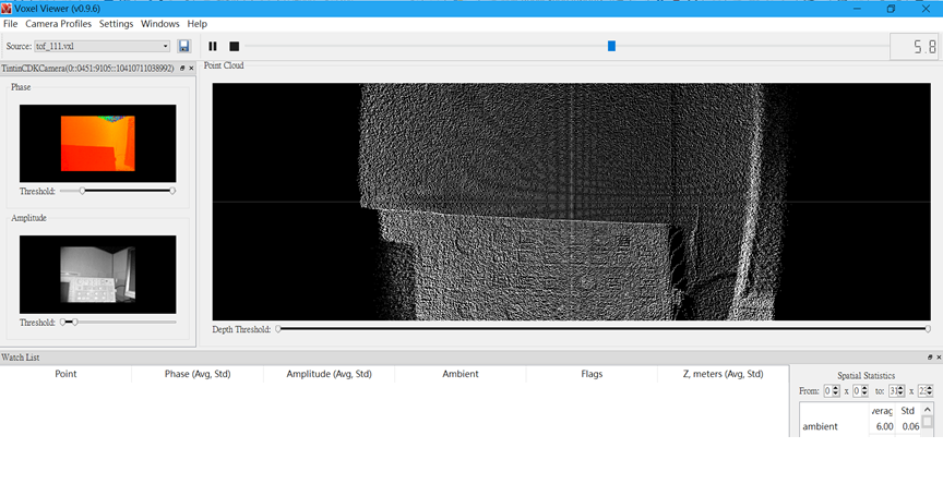

We would like to steram multiple OPT8241 cameras synchrously.
The flow is designed as follows.
1. Connect Camera 1 to the computer with USB cable.
2. Start Voxel Viewer and start streaming.
3. Connect Camera 2 to the computer with USB cable.
4. Start another instance of Voxel Viewer and start streaming.
We will need to register call back twice, one for each camera. Each camera should have a different buffer.  (refer: github.com/.../Qt)

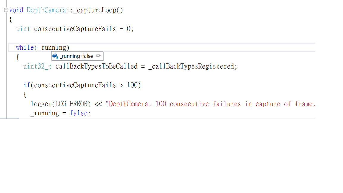

First we try to integrate grabber.cpp and grabber.h(in github.com/.../Qt) to my main code.We found that callback function execute only once and can't continue to run again.Why?
Which setting is ignored in main code? What can we do next step?
ShengHua

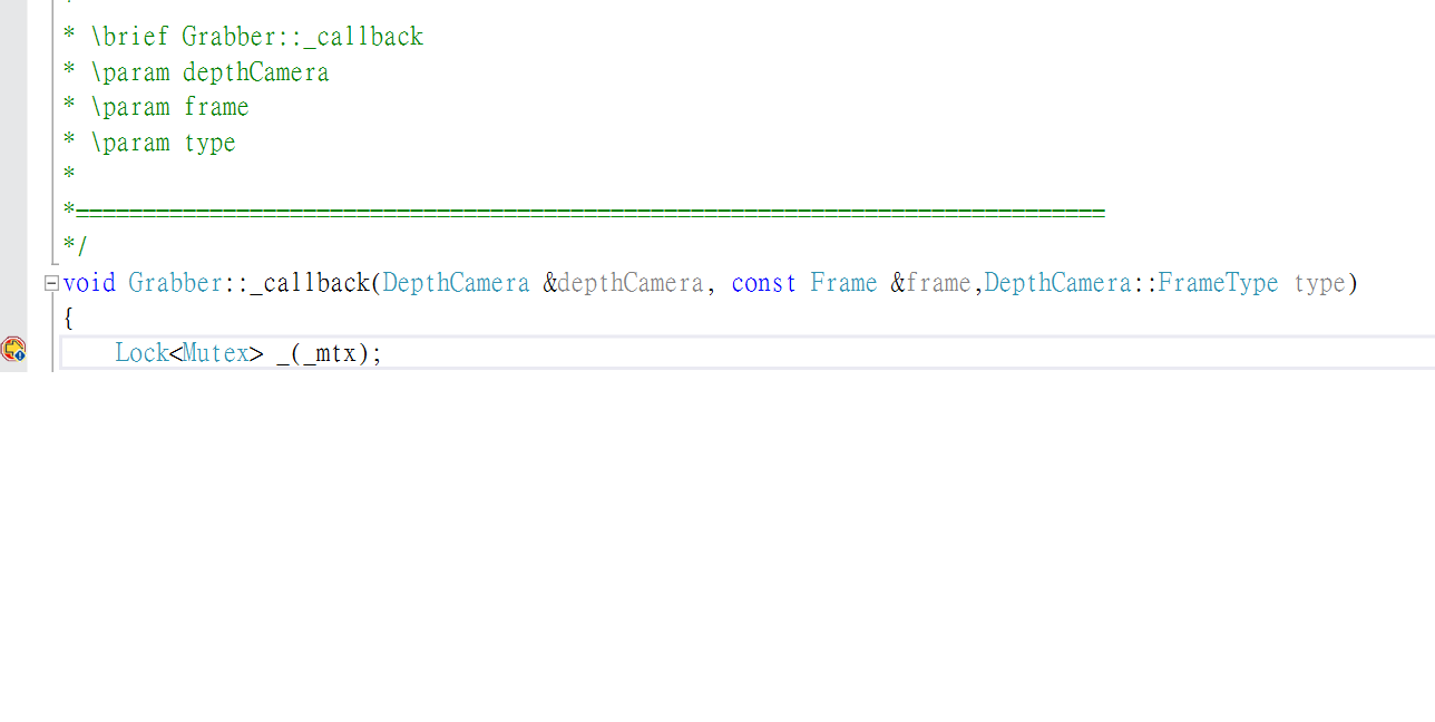

The partial code is as follows.
main code:
CameraSystem sys;
// Get all valid detected devices
  • const Vector<DevicePtr> &devices = sys.scan();
  • DevicePtr toConnect;
  •  DepthCameraPtr depthCamera = sys.connect(toConnect);
  • Grabber Grabber1(depthCamera, Grabber::FRAMEFLAG_DEPTH_FRAME, sys);
  • Grabber1.start();
In grabber.cpp
void Grabber::_callback(DepthCamera &depthCamera, const Frame &frame,DepthCamera::FrameType type)
Lock<Mutex> _(_mtx); // run only once
else if (type == DepthCamera::FRAME_XYZI_POINT_CLOUD_FRAME)
if (_qXYZIFrame.size() >= FIFO_SIZE)
XYZIPointCloudFrame *f = _qXYZIFrame.front();
_qXYZIFrame.pop_front();
if (f != NULL)
delete f;
XYZIPointCloudFrame *nf = new XYZIPointCloudFrame;
*nf = *dynamic_cast<const XYZIPointCloudFrame *>(&frame);
_qXYZIFrame.push_back(nf);
_frameCount++;

    As you indicated, each Grabber has its own buffer and loop. You will have to register two separate callbacks, one for each. It's hard to see from you code snippet if that is done. If you can share the full code (send to ti-3dtof@list.ti.com) we can better help you.
    -Larry

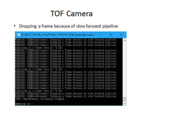

  • Dear All:
           We would like to stream TOF Cameras by register callback function. First we try to integrate grabber.cpp and grabber.h(in github.com/.../Qt)
           to my main code. By setting frame rate to 30 fps and Camera profile then run Grabber1.start().
           We found the frame rate is nearly 6 fps due to drop a frame in a slow forward pipeline.  Why? How to do next step?

  • Dear Larry:
    Thanks your kind support. We try to rewrite a callback function then test the PCL callback function. After connect multiple TOF cameras, the frame rate of grabber is nearly 30 fps. Now we would like to integrate algorithms for multiple camera callback and found the frame rate is reduced to 12 fps due to slow forward pipelines. In our application, we hope to keep the frame rate to 30 fps with image process algorithms. How can we do next step? Using multiple thread for each callback function or other methods?
    ShengHua
  • Using multiple thread is one possibility. Also make sure you're using a FIFO and not doing too much processing inside your callback.
  • Dear Larry:
    OK. How can we use a FIFO in the PCL callback?
    Is there an example for this case in muliple cameras synchronization?
    Thanks your support.
    ShengHua
