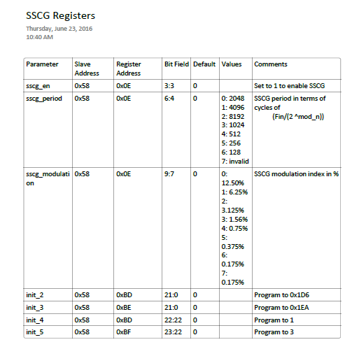

Can I enable SSCG function of OPT8241 by VoxelViewer-0.7 ??
