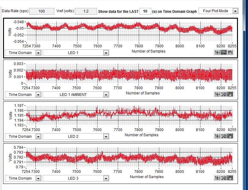

When I connect the board to the PC I can see green led and red led is working but when I'm in capture mode just green led is working. Furthermore, the red and IR leds signals are really low being almost 0. I read SFH 7050 datasheet to know which is the working current for all leds but even configurating the leds correctly does not work. I attach a picture.

    Green LED captures HR much easier than red. You may want to try to pump up the LED current and gain stages in order to see HR for red LED
  • Thank you for your answer. I incresed up the red and IR LEDs current and I got a better response. Hovewer  the noise is quite high  and not always with the same average, at some momens the noise is higher than the others(I'm using the pc battery supply). Could I get a better response ? I attach you a picture.

  • Joan,
    Noise can depend on many things while you are measuring. Try not plugging in the PC, which I think you did. Try the test setup in a different location. For more information on testing the device and EVM, you can look at the User's Guide and datasheet.
