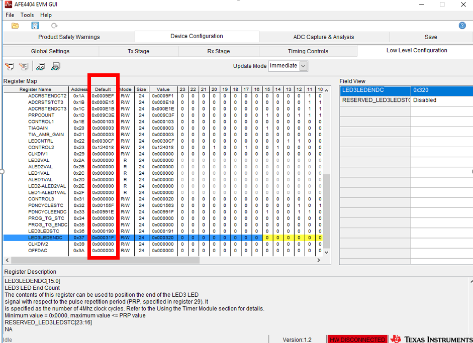

  • Hi Oshrit,
    You can refer to figure 8 of following document for the sample PPG waveform.
    www.ti.com/.../slau621a.pdf
    Did you try with the default register setting from the AFE4404EVM?
    Prabin
  • Hi Prabin,
    Thanks for your quick answer!
    I using an ST EVB and I connect it to IT's EVB (AFE4404). Therefore, I cannot use the  AFE4404 EVM GUI to see the waveform.
    I tried with the default register as shown below:

    But the waveform that I see after 10 seconds from the 0x2F register look like:
    (It looks like there should have been at least double pulses in that amount of time )
    What do you think is the problem?
    Thanks in advance,
    Oshrit
  • Hi Oshrit,
    You might be picking noise from AC mains.
    Try running your test from battery powered device.
    Prabin
  • Hi Prabin,
    Thanks for your help. It seems like it's working ok now.
    You can see below.
    Oshrit
