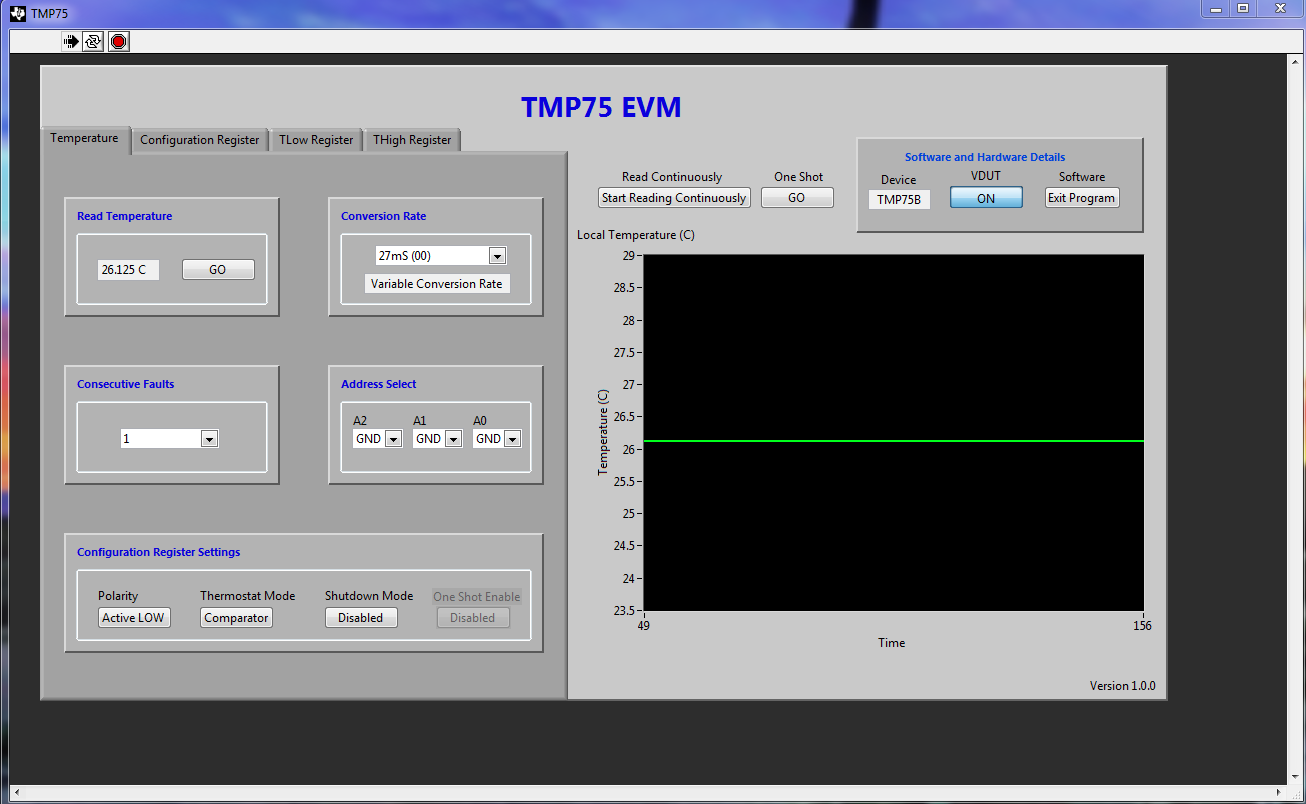

We are evaluating the TMP75C. The datasheet states it has a 12-bit converter. However, the 12-bit value we read always has zero in the least significant two bits. So we are only seeing 10-bit conversion. I don't see anything in the configuration that would cause the device to do a 10-bit conversion. Has anyone seen this device work with 12 bits?
