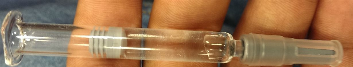

Hi i am starting a project called Temperature logger. For my project I selected a IC which part Number is RF430FRL152H. I wanna use TMP006/B infrared Thermopile sensor for my project. My question is can i use TMP006/B IC with RF430FRL152H IC? If i can then how can i connect TMP006/B with RF430FRL152H?  Thank you for help.

    Thank you for reply. In your answer you mentioned separate supplies for ICs. What you mean by overlapping?  Is it meaning I need to supplies separate power for ICs? When i read RF430FRL data sheet I saw this ic can take power from antenna. Actually I want to use RF430FRL and IR temperature sensor for my project. Actually I want to make a device and that device will measure the temperature to a liquid medicine like picture and finally device will send the data in to the mobile through NFC. Can you suggest me some appropriate ICs for my project?
