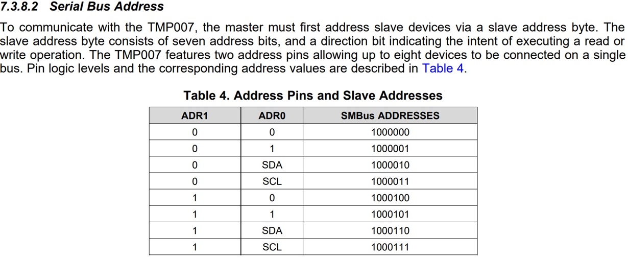

2) Although the datasheet says that this sensor can have up to 8 different I2C addresses, I had some doubt with this.
Is it really true that the slave address can be configurable when the ADR0 pin is connected to SDA or SCL pins without extra configurations or conditions?
(Ex. use 4.7kΩ pull-up resistor or less, cannot use I2C and must use SMBus format, etc)
To use all 8 sensors, that ADR0 configuration is important to me.
However, it is my first time using both LAUNCHXL-CC2640R2 and TMP00x sensor. So I'm quite worried to buy them without the answer that 8 slave addresses can be configured with ease.

    2. Yes, it is true. The device internally monitors the ADR0 pin during the I2C transaction to detect the correct address. There's no need for special configurations or conditions.
