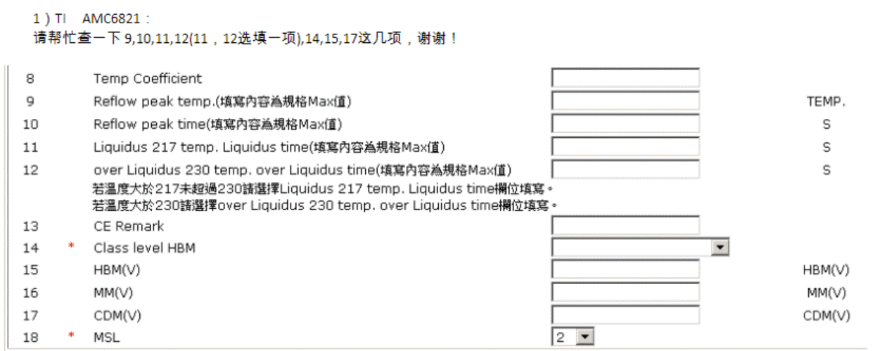

Hi Sir :
    I can't get some parameters for Factory production of matters needing attention  form datasheet. pls help check  and  Complete the following parameters

  • Hi Lei,
    I was able to find all parameters except item 8. I wasn't sure what type of temp coefficient you are referring to. It is unclear exactly what you are asking for. TI doesn't calculate package level CTE. Are you referring to the thermal coefficient in the the thermal resistance? Please advise.
    Here are the paramters.
    9. Peak reflow temperature is 260°C max
    10. Peak reflow time : 30 sec max within 5 degree to peak temperature
    11. Total time above 217°C is 60-150 sec
    12. Same as item 11
    13. n/a
    14. Classification level 2
    15. 3kV
    16. 200V
    17. 1kV
    18. Level-2-260C-1Year
    Hope this helps. Let me know if you have further question.
