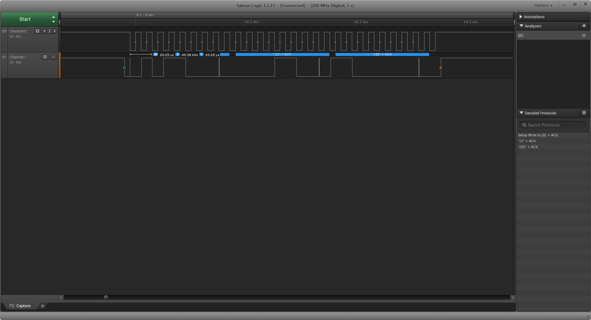

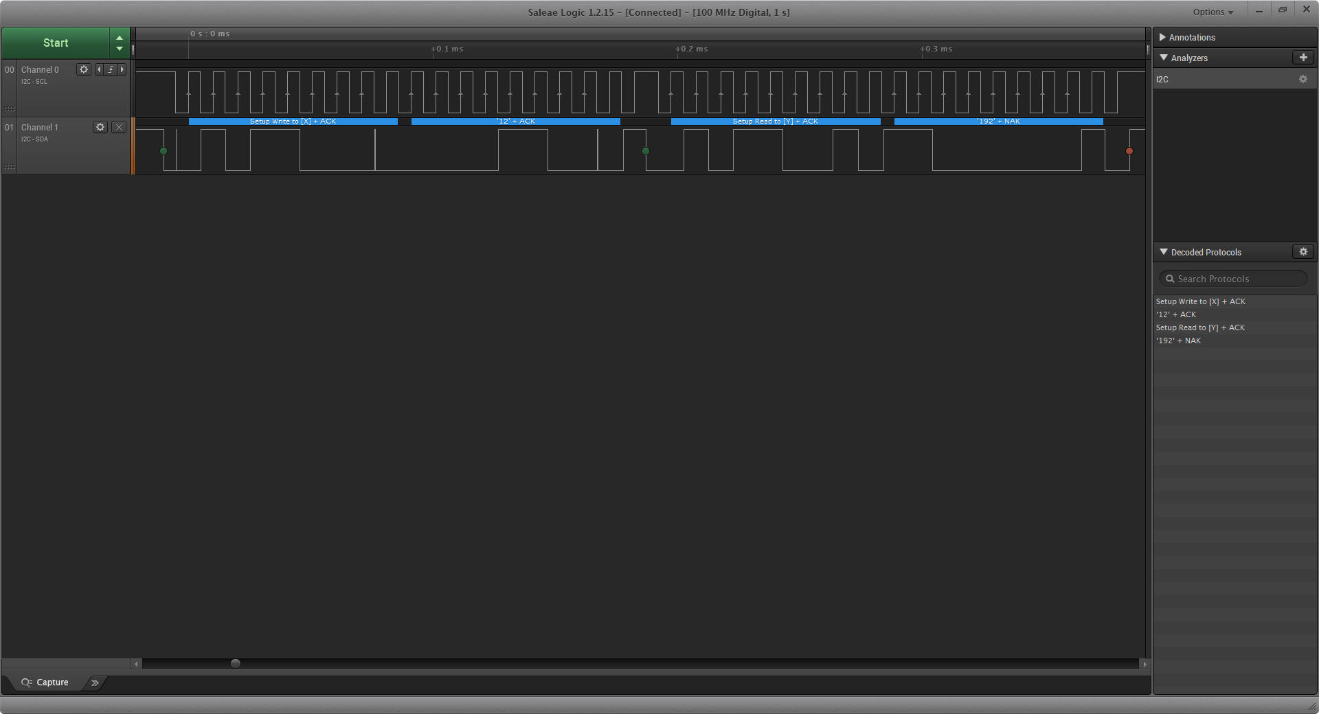

  • Hi David,
    Thank you for shipping the board to me. I reviewed your schematic and your board. I do not see any issue. The LM96194 provides two registers of 8-bit in order to form 16-bit register. So, in this case the PWM1 contains 9-bit register which contains high byte and low byte. In order to prevent any discrepency when reading or writing the value, there is a reading and writing scheme that you must consider. Any register is greater than 8-bit, the value must written into the low byte first before you can write to the high byte. Writing to the low byte first will lock the value of high byte. It is very similar to reading from the device as well.
    Please refer to page 30 of the datasheet for more detailed information.
    Let me know if you want me to ship your board back.
    Aaron
  • Hi David,
    I forgot to attach the snapshot.
    Hope this helps. Let me know you have further question.
    Read:
    Write:
    Aaron
