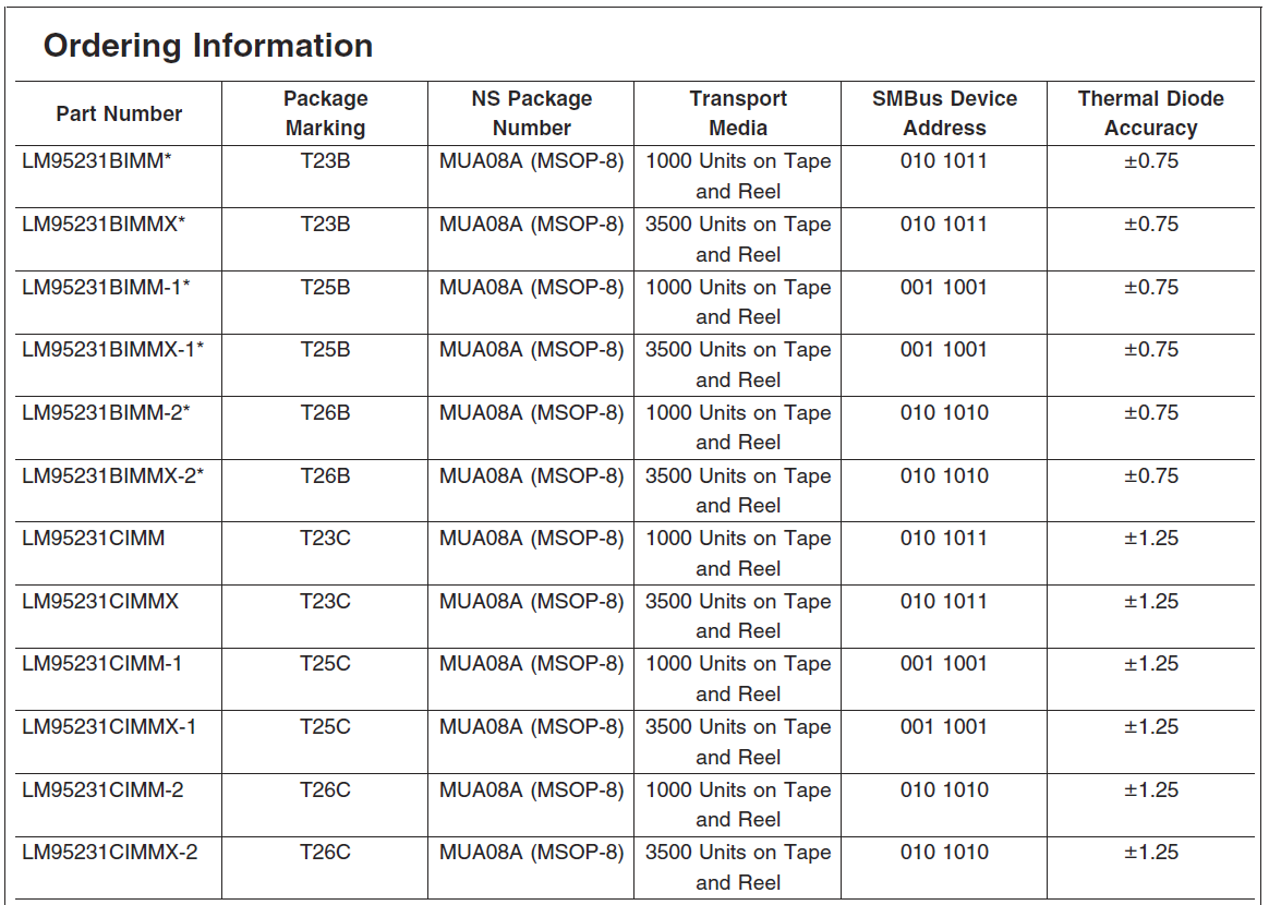

I have bought LM95231CIMM/NOPB and downloaded the data sheet (rev E) from ti.com. In this document it says that the SMBus slave address for my part 1010111, but the address of the device corresponds to the description of the manufacturer National Semiconductor – 0101011. I have checked the marking on the part: 34CE T23C.
My question is why the SMBus address LM95231CIMM / NOPB does not match the data sheet (rev E) from ti.com.?
