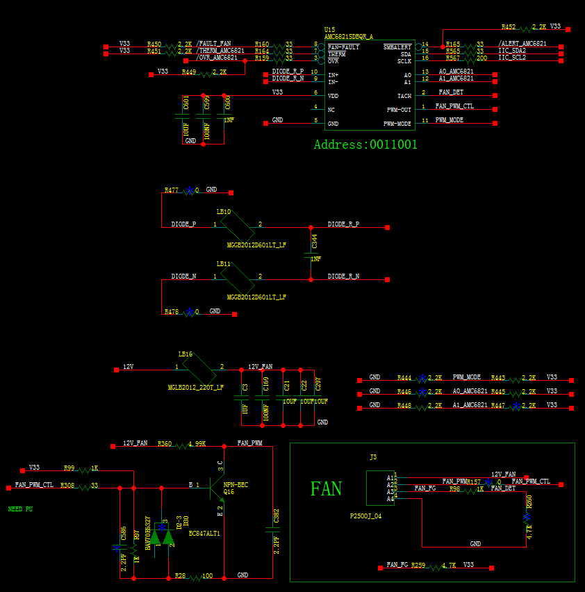

Hi, Team:
1. My customer use AMC6821 to drive a 4 wire Fan and monitor the RPM every 5s.
They found some time the FAN stopped; if they find the FAN stop after 30s, they will write a 100% PWM and make the FAN recovery.
For the chip power up initialization, they just set the FDC1: FDC0 = 00, write the DEC to 0x22, keep other register no change.
When read the RPM, They set the TACH_EN: TACH_MODE = 11;
Because such issue happen in their end customer, they cannot dump the register. But they confirm that the temperature read back is correctly.
Do you have any experience or debug solution for such issue?
2. One month ago, the customer report that some system fan stop and they found the PWN_EN =0; but they feedback host didn't do any operation on the chip. Any reason make the chip change the PWN_EN from 1 to 0 by itself?

  • Hi, Kelvin:
    The feedback as below:
    1. this is not new design, the custoer already use this device for several projects.
    2. not all of the product have this issue. about 4/120pcs have this issue. but this four fail euipment is in different city.
    3. See below schematic.
    4. Yes, it is 100% recovery.
    5. They didn't duplicate such issue in their lab, but from their field log information, the PWM_EN = 1 and never = 0.

  • Andrew,
    1. They never had any issues with the previous projects? Did they use a different manufacturing flow for this project?
    2. Are they planning on debugging these failed units in the lab? The need to be able to recreate the fail condition in the lab. Why would the 116 units work fine but not the other 4?
    3. Are you saying that the field log (PWM_EN = 1) contradicts what the customers observed (PWM_EN = 0) on the PWN_EN bit?
    4. No EEPROM or flash that I know of.
    BTW, I don't understand what you mean by "write the DEC to 0x22".  0x22 is an 8-bit register.  What is "DEC"? You mean "DCY"?
    -Kelvin
