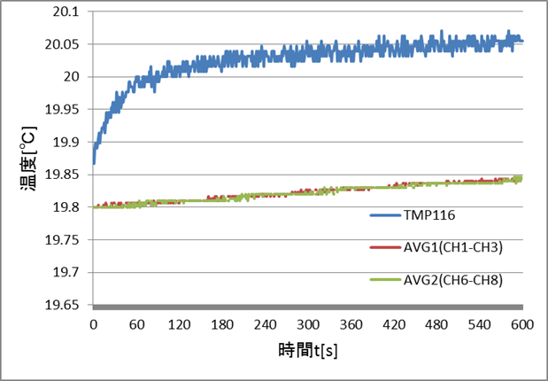

 One of our customers is evaluating TMP116 using the device EVM (TMP116: http://www.tij.co.jp/jp/lit/ug/snou145a/snou145a.pdf). In their evaluation, they found TMP116 output temperature data is higher 0.21C than the data of very high accuracy thermometor they provided when Continuous conversion mode is used. Then TMP116 temperature data is 20.035C and the thermometer is 19.825C. But when one shot mode is used, the temperature data is same as the thermometer data (19.825C).
 Is the cause of the temperature difference in the continuous conversion mode TMP116 self heating?
 Also the device datasheet says that the temperature error with Continuoue conversio mode is about 60mC at 5V. But the error temperature the customer measured is 210mC. It is 3 times error compared with Figure 4 on page 4 of the device datasheet.
 Could you please tell me your idea why the 3 times error is occurred?

    They don't use temperature chamber. Instead of that, they prepared a very dark room with no window and small box in the room for the evaluation of TMP116. all sensors are in the box.
    Also the reference temperature is measured by high accuracy thermometer developed by themselves.
    The distance between TMP116 and the thermometer is about 10cm(100mm).
    They use TMP116 sensor portion of EVM with dividing at the breakouts point of EVM and connect the PCB TMP116 mounted to USB control PCB with 10cm wires.
    The following graph is  their measurement result with Continuouos Conversion Mode. The X axis is Time (seconds) and Y axis is Temperature measured by each sensor. According to the graph, the temperature measured by TMP116 is about 0.2C higher than the reference temperature at 300 seconds.  The customer knows that the temperature data shows higher temperature than actual one when the continuous conversion mode. But they'd like to know whether 0.2C higher is reasonable or not?
    Could you please give me your answer or comment?

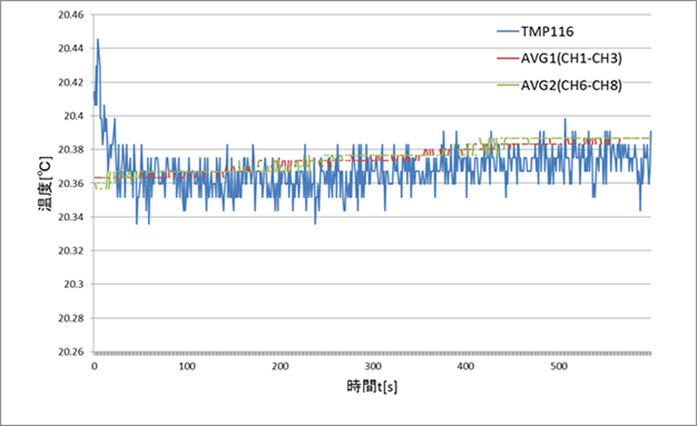

    Also the following is the data measured by one shot mode. You can see the temperature data is higher than the references at the measurement starting point. Is TMP116 default conversion mode continuous conversion mode? Is this phenomenon reasonable?

    Thank you so much for providing the detailed information. There are two possibilities that could cause the temperature offset. According to your description, customer was using the TMP116EVM to perform the temperature correlation.
    • I realized that in the TMP116EVM, the TMP116 thermal pad is soldered down. . We learned that soldering the thermal pad creates a lot mechanical stress on the die since the sensing element is in the corner of the die. So, when the DAP is soldered, the edge of the 4 sides are pulling and stretching downward. For this reason, it effects the temperature accuracy for ±0.1°C, but still meets at ±0.2°C.
    • In the EC table of page 5, the Standby current and Shutdown current are 1.25µA and 250nA. Normally, one-shot mode performs better temperature accuracy than continuous mode due to less self-heating effect. This due to the time delay between one-shot conversion and temperature data read is long enough to allow self-heating to be reduced. However, in continuous mode self-heating effects are usually much larger since the default delay between conversions is typically very small.  The self-heating effect can be reduced somewhat by increasing the conversion cycle time as indicated in table 7 on page 26 using the 3 CONV bits in the configuration register. I would suggest to increase at least 500ms or 1 second to see the effect.
