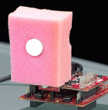

3.4. The closed-top twisted pair transducer hangs from the daughtercard, and tends to points down. How do you recommend I mount the transducer with a support or stand?
Initially, use the packaging sponge from the box the BOOSTXL-PGA460 was shipped in as mounting material for the twisted pair transducer. Cut out a 5cm x 5cm square of sponge, and puncture the center with a pen sized hole. Lodge the transducer in the hole of the sponge. The soft sponge like material is ideal because it will not load or dampen the vibrating mechanics of the transducer shell. The transducer should not be fastened with a metallic vice or clamp, taped to the table, nor held by the user’s fingers, as this will reduce performance. The fewer materials making contact with the transducer shell, the better the performance. Fastening the twisted cables, with minor contact to the rear of the transducer is an alternative to securing the shell. For module sized solutions, a rubber gasket is typically used to hold and seal the module in place, and to isolate the circuit from the outward facing transducer.
Figure 3. Transducer mounting options

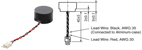

3.5. Is a transducer’s pin polarity important?
Some transducers have a pin polarity marker, while others are reversible (non-polar). Typically, closed-top transducers have polarity due to the conductive shell connecting to the negative terminal. Grounding the negative terminal is crucial for ESD robustness when the shell of the transducer is the discharge point for the ESD source. The ultrasonic returns at the positive terminal are superior to the returns seen at the negative terminal, since the shell is more likely to pick-up environmental noise. The majority of open-top transducers are non-polar due to their plastic, non-conductive, or floating shells, though some, such as the Murata MA40H1S-R, do have conductive shells shared with the negative terminal. Be sure to read the transducer’s datasheet to determine if polarity must be considered.
Figure 4. Transducer pin polarity examples

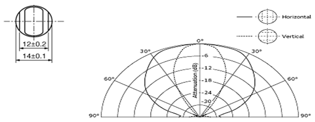

3.6. Is a transducer’s face orientation important?
Some transducers have varying degrees of coverage in different axes. For instance, the Murata MA58MF14-7N has a wide field of view (FOV) in the horizontal axis, but a narrow FOV in the vertical axes. Meanwhile, the Murata MA40H1S-R is has the same omni-directional FOV in the x-, y-, and z-axis. To determine the face orientation, typically a mechanical or visual marker is provided. The Murata MA58MF14-7N should be oriented such that the white epoxy slotted backing and rear cutouts stand upright.
Figure 5. Beam pattern of MA58MF14-7N in horizontal and vertical axes

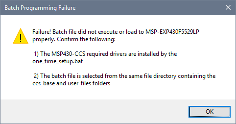

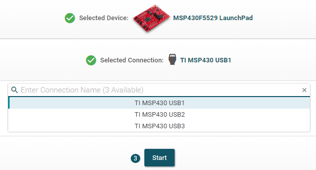

4.2. The “boostxlpga460-firmware.bat” batch file fails to install.
Figure 6. Batch Programming Failure prompt
If the batch file fails to install, ensure the MSP430 and Code Composer Studio (CCS) driver files successfully installed during the PGA460-Q1 EVM GUI install wizard or when manually installed by the “one_time_setup.bat” file. Refer to question 4.1 for additional details on the driver file installation. The “boostxlpga460-firmware.bat” must be loaded from the same directory containing the “ccs_base” and “user_files” installed during the PGA460-Q1 EVM GUI wizard. All aforementioned files and folders will be stored in the install-created folder at “DocumentsàBOOSTXL-PGA460” or “My DocumentsàBOOSTXL-PGA460”.
The batch file must only be flash programmed onto the MSP-EXP430F5529LP once during initial setup. Unless the LaunchPad is repurposed or programmed for a purpose other the PGA460-Q1 EVM GUI evaluation, the user will not have to repeat the batch file upload.

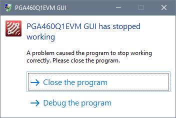

4.3. I cannot open the GUI. A Windows dialog box immediately opens stating, “PGA460Q1EVM GUI has stopped working”.
Figure 7. PGA460Q1EVM GUI open error
This problem is typically a result of the GUI executable being run outside of the installation directory. The “PGA460Q1EVM-x.x.x.x.exe” must be run from the same folder containing the “USB2ANY.dll” and “Microsoft.VisualBasic.PowerPacks.Vs.dll”. These DLL files are installed in the same path as the executable when using the PGA460-Q1 EVM GUI install wizard. The GUI depends on these two DLL files to initialize and function properly.

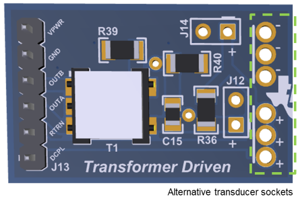

4.4. How do I use a different transducer on the transformer driven circuit?
To use a different transducer on the transformer driven circuit, desolder the Murata MA58MF14-7N from the J12 socket. TI also recommends that the tuning capacitor of 1500pF at C15 and damping resistor of 2.7kΩ at R38 be desoldered to enable the transducer to resonate freely and without being unintentionally detuned. The new transducer can be populated at J12, or across the alternative transducer socket’s positively and negatively marked terminals on the transformer driven half of the daughtercard. If a tuning capacitor and damping resistor are required for the new transducer, refer to the PGA460-Q1 Ultrasonic Module Hardware and Software Optimization application note for guidance.
Figure 8. Transformer Driven Transducer Substitution

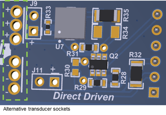

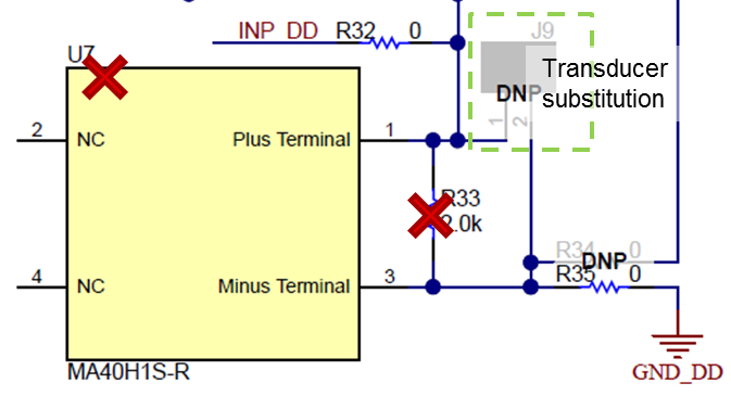

4.5. How do I use a different transducer on the direct driven circuit?
To use a different transducer on the direct driven circuit, desolder the Murata MA40H1S-R from the U7 pads. TI also recommends that the damping resistor of 2.0kΩ be desoldered to enable the transducer to resonate freely. The new transducer can be populated at J9, or across the alternative transducer socket’s positively and negatively marked terminals on the direct driven half of the daughtercard. If a damping resistor is required for the new transducer, refer to the PGA460-Q1 Ultrasonic Module Hardware and Software Optimization application note for guidance. Tuning capacitors are not required for direct-driven transducers.
Figure 9. Direct Driven Transducer Substitution

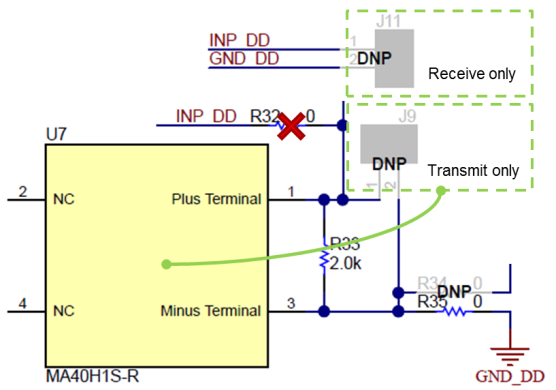

4.8. How do I enable the daughtercard to use a bi-static transducer pair (a separate transmitter and receiver)?
For the transformer driven mode, desolder the 0Ω resistor at R36. This disconnects the return path typically shared with the transmitter’s positive terminal. Connect the receive-only transducer to the J14 socket.
For the direct driven mode, desolder the 0Ω resistor at R32. This disconnects the return path typically shared with the transmitter’s positive terminal. Connect the receive-only transducer to the J11 socket.

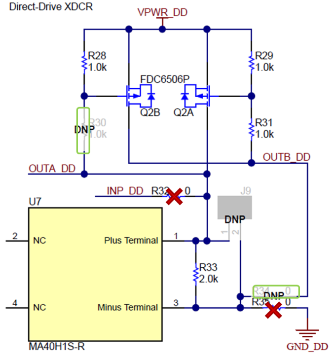

4.9. How do I enable the daughtercard to use full-bridge direct drive in bi-static mode?
Full-bridge is only available for the bi-static mode, and can be enabled by making the following hardware changes:
- Desolder the 0Ω resistor at R32. This disconnects the return path typically shared with the transmitter’s positive terminal. Connect the receive-only transducer to the J11 socket.
- Desolder the 0Ω resistor at R35, and use the same 0Ω resistor to populate resistor R34.
- Populate the 1kΩ resistor at R30.
Figure 11. Full-bridge bi-static mode modifications

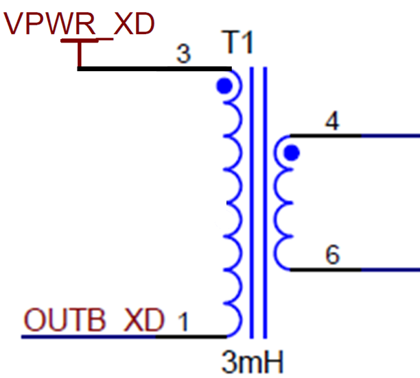

4.15.How do I use a single-ended transformer instead of a center-tap transformer?
To use a single-ended transformer to substitute a center-tap transformer, only the OUTA or OUTB pin must be used. The primary windings would be connected such that one end is connected to a constant supply rail (such as VPWR), and the other end is connected to OUTA or OUTB. If OUTA is used, then OUTB will be floating, or vice-versa.
Single-ended transformers are able to drive the transducer during half of the period, while the transducer’s resonance drives the remaining half of the period in the opposite direction. Therefore, single-ended transformers are slightly less effective in generating maximum sound pressure level when compared to center-tap transformers. A center-tap transformer can be used in single-ended mode to change (decrease) the turns-ratio.
Figure 14. Transformer Connections

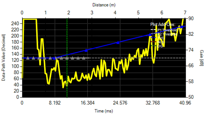

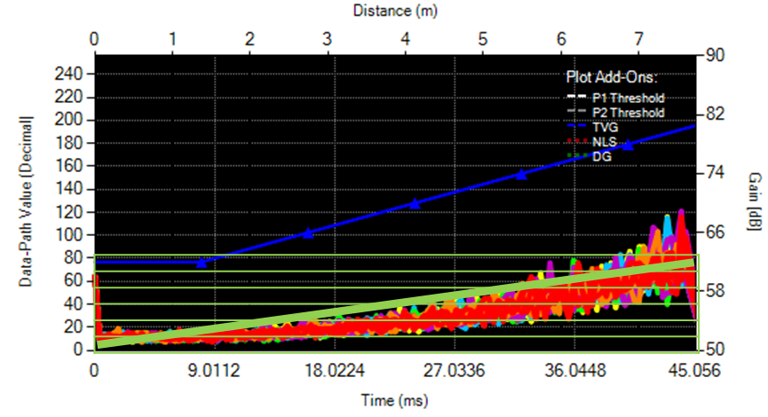

5.6. The ultrasonic measurement result data is random, very short, always the maximum value, or never updates.
Before the ultrasonic measurement results can be of any use, the thresholds must be mapped for object detection based on the echo data dump profile. Use the mid-code threshold timing and levels option to bypass the need for manual threshold optimization. The mid-code option sets the threshold to a fixed 50% detection level.
Figure 20. Mid-code threshold times and levels
If the threshold has been set appropriately, and the value returned is always less than 1cm, then the threshold is initially set too high, but not maximized. At low analog gains, the DSP output supplied to the data comparator to detect a threshold crossing initially ramps during the burst and decay window. As a result, the echo data dump equivalent is not immediately saturated as it is represented in the analog domain, thus the threshold comparator can be false-triggered by the initially ramped DSP output. To prevent this false-trigger, initially set the threshold to the maximum value of 255, increase your threshold deglitch time, or lower the threshold such that ramping is at an initial value above the threshold level. Alternatively, set the initial gain to a larger value such that the ramping is saturated, and does not trigger the threshold.
Figure 21. DSP output ramp triggering a false positive
Best practice is to initialize the TVG and/or SR digital gain to a large value during the expecting burst and initial decay window, and radically reduce the TVG to a lower value during the later portion of the decay period to enable short range detection.
Figure 22. TVG max-to-min trough to saturate initial burst of echo data dump
If the threshold is always at a maximum value, the threshold is set too high throughout the entire profile, or no object is detected. Reduce the threshold levels to force the threshold comparator to trigger. A forced trigger will confirm whether a burst-and-listen command has truly executed.
If the ultrasonic measurement results (UMR) are not updated, ensure that the DATADUMP_EN bit of the EE_CNTRL register is disabled (default). If the DATADUMP_EN bit is enabled, the echo data dump memory is filled, and the UMR will not update since the threshold comparator disabled. Only the echo data dump memory can be filled, or the ultrasonic measurement results be captured, but not both simultaneously. When the GUI displays the echo data dump and captures the ultrasonic measurement results, two independent burst-and-listen commands are run sequentially.

5.13.I am not able to detect an object using the Energia sketch, or the object distance is always the same.
The Energia sketch uses a fixed level threshold and a fixed level time varying gain. Try various combinations of setting the threshold and TVG to the different percent-from-maximum levels. The options include 25%, 50%, and 75% of the maximum. If no object is detected, increase the gain range or gain percentage. If the object distance is always the same, typically the same short distance value, increase the threshold or reduce the gain range or gain percentage. Fine-tuning of the hard-coded user EEPROM values may be required. The hard-coded values can be modified in the pga460_ussc.c library file.

6.1. There appears to be a continuous noise source present.
If you are using the listen-only command, and are recording a large noise floor on the echo data dump, an ultrasonic aggressor may be present in the immediate area. Common aggressors include ultrasonic based room occupancy sensors, AC power supplies for laptops or bench equipment, and harmonic noise from other user components on custom hardware (such as motor switching noise). Try isolating the transducer by shielding its field of view, running the EVM using only the laptop in USB-boost power mode (LP-USB populated on Alt Pwr Mode jumper block), and/or going to an electronically-quiet room or outdoors.
Figure 26. Murata MA40H1S-R noise floor saturated based on Listen-Only command in a room with 40kHz occupancy sensor
6.2. A false echo positive is always present at 7.7m, even when the transducer is disconnected. Why does the PGA460 detect this unreal artifact on the echo data dump?
If you are using the TI factory EEPROM settings, then the Time Decouple mode is enabled after 45.056ms from the time of bursting, or the distance equivalent of 7.7m. The toggling of the decoupling pin acts as an unintentional internal noise source, coupling onto the analog front end’s return path. As a result, this toggling depicts itself as a false echo positive. However, the decoupling feature can be useful if the transformer is continuously susceptible to noise from the environment, such as in industrial use-cases. If you do not intend on using the time decouple feature, maximize the enable time to 65.546ms. Otherwise, map the threshold around the decouple-produced peak, which will be fixed and repeatable. You may or may not be able to detect a real returning object at the same instance time decoupling is enabled, as this will depend on the returning echo’s strength.
Figure 27. Time decoupling toggle noise at 45.056ms

- Four Layer Board Option
- Additional grounding layers will help with noise rejection on the board level.

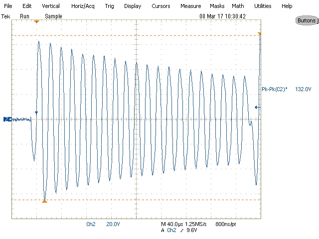

6.4. In transformer driven mode, the secondary voltage appears as a distorted sinusoidal waveform. How do I clean-up my driver signal exciting the transducer?
The most influential variables responsible for forming the sinusoidal driver at the transducer are the external tuning capacitor and damping resistor values. See the PGA460-Q1 Ultrasonic Module Hardware and Software Optimization application report for details on selecting these values. The current limit can also impact driver cleanliness. If the transformer is saturated through the primary windings, then distortion will be present at the peaks of the waveform. Reduce the current limit until the peak is no longer distorted, but still maximized in peak-to-peak amplitude. Though a clean driver is ideal, more sound pressure level is still be generated from a larger peak-to-peak distorted sinusoidal waveform. Ensure the current limit is enabled in transformer driven mode.
Figure 28. Transducer Driver Waveform Smoothness

6.6. How can I determine the characteristics of my transducer if no datasheet is provided, or I do not have an impedance gain-phase analyzer?
The transducer’s frequency diagnostic feature enables the PGA460 to measure the resonant frequency of the transducer during post-burst decay. This can be used to find or optimize the PGA460 driving frequency to match the resonant frequency of the transducer to produce the maximum amount of sound pressure level for long range applications. Sweep the frequency diagnostic’s window length and start time parameters to collect an averaged representation of the transducer’s resonance. Properly settings these parameters also allow for any drive-to-release detuning to subside, which is typically observed immediately after releasing the driver. See the PGA460-Q1 Ultrasonic Module Hardware and Software Optimization for details on how much of an impact the PGA460 set frequency has on the returning echo’s peak amplitude.

6.8. When should I use the Disable Current Limit feature?
Disabling the current limit is only recommended for direct driven mode or high-frequency (180 to 480 kHz) transducer evaluation. Do not disable the current limit for transformer driven mode, because the PGA460’s internal nMOS FETS are only rated for 500mA. Transformers typically paired with the PGA460 are able to generate 2A of sink current without a limit.

7.2. When in doubt, restart the GUI and hardware.
If the EVM hardware is disconnected or unpowered while the GUI is open, or the GUI starts to respond abnormally, TI recommends to fully restart the GUI to ensure the PGA460 device settings are updated and reference the most recent values.
