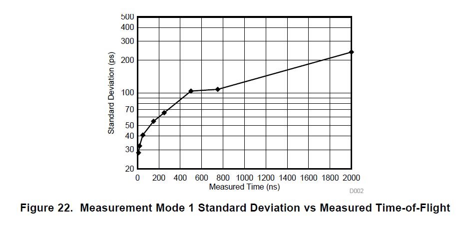

1. For Mode1 used, why does the standard deviation get ramp up from 800ns to 2000ns on Fig. 22 as below.

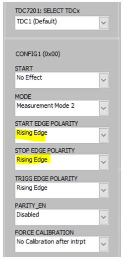

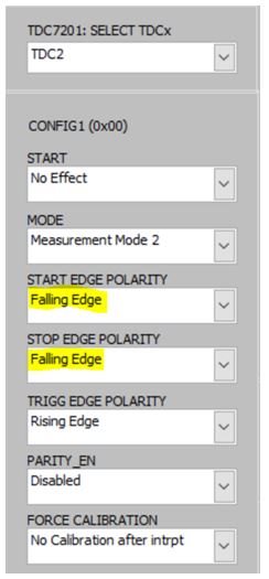

3. TDC7201 support TDC1/ TDC2 for different channel, may I setup different Edge Trigger for Rising/ Falling at two channel? Whether have any risk issue when using different edge trig?
     EX: TDC1 setup to Rising Edge for Start/ Stop and TDC2 setup to Falling Edge for Star/ Stop as below.
    1. For mode 1 a ring oscillator is used, and as the counting time increases the oscillator heats up, which increases the jitter and therefore the standard deviation. It is not recommended to use mode 1 for measurements greater than 500ns.
    2. There is not currently a chart that shows the standard deviation of the mode 2 measurement vs time of flight. The standard deviation remains relatively constant over time, but is affected by the frequency of the input clock as shown in Figure 20 on page 12 of the datasheet.
    3. You can set up the edge triggers to be different between the two channels with no problems.
