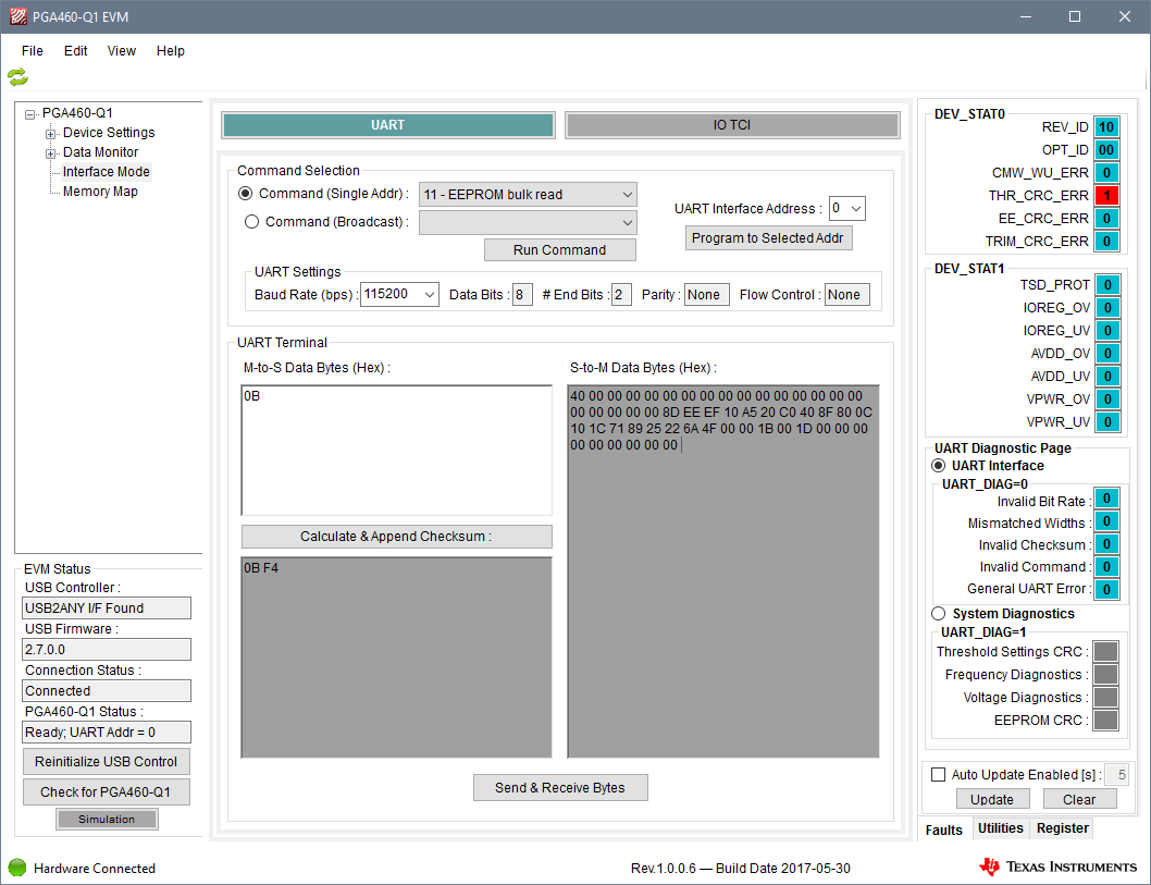

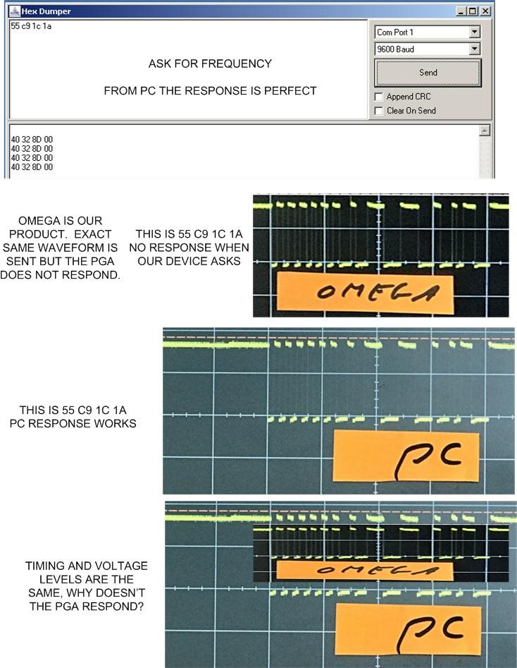

We have the PGA460-Q1 Eval module and everything works perfectly for our application. We are trying to watch the RX and TX serial data that the PC sends and receives to the Eval board. We can clearly see the 55 and all RX and TX waveforms on the scope. We use a simple 3.3V to RS-232 converter to watch the hex data on a serial monitors. The data is random 00 FF 0C.... but we cannot determine the baud rate that the EVM is using.
I know that it autobauds on the 55 but our serial monitor cannot auto baud.
What is the Baud rate when the EVM does all of the register transfers and Commands? 115k, 9.6K... do not seem to work.
