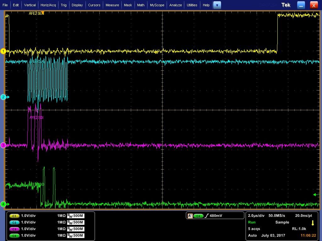

- We tried connecting all AFE2 to AFE1 signals  (except for their SDO)
- AFE1 SDO on power-up measure approx. 0.3v while the BAD AFE2 SDO is 1.8v
Attached plot screen shot and layout & schematics.

    Your schematics show the same nets for both AFE5818's SPI pins (even SEN). Please make sure they are not shorted internally on the board.
    You also did not show the SEN signal and the 2nd AFE5818's SPI signals in your oscilloscope capture--please add that and also label the scope channels.

    AFE1 SPI read:
    Preforming a read on AFE1 and its acknowledge.
    AFE2 SPI read:
    AFE2 only acknowledge when both PWD_FAST = ‘1’, and only if not releasing one of the PWD_FAST to ‘0’

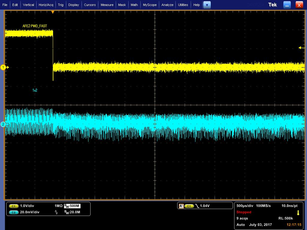

    AFE2 PWD_FAST vs 1v2:
    PWD_FAST going low and what happens on 1v2 rail.

    Your AFE2_3.3V should not be shorting because you changed input capacitors. Please make sure there is no errant solder on the board causing a short somewhere.
    Are you saying that your AFEs can communicate fine via SPI when PDN_GBL is asserted but stop communicating once it is deasserted? That is very peculiar behavior.
    If you have an unexpected short on the AFE2 side of your board, it is possible that when PDN_GBL is asserted, the circuit using the shorted supply is also powered down leading to no issues but once that circuit is active, it causes problems with AFE2.
    And I think plots showing what happens to AFE2's supplies when PDN_GBL is deasserted would provide better information.
