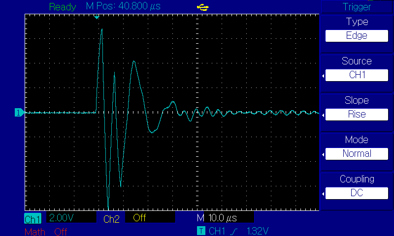

I'm using PGA460 to measure the distance and I had a problem while using 200kHz transducer. The transducer that I'm using here: https://www.steminc.com/PZT/en/air-transducer-200-khz

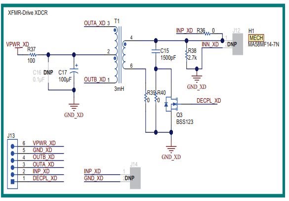

Schematic:

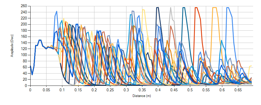

Below is some images that I measured signal on the transducer output (P41 in schematic).
You can see in the echo dump data figure that it's hard to detect where is the echo pulse.
I've use the same circuit (with different value of C43 and C44) with 40kHz transducer and I can detect the echo pulse to detect the distance but it doesn't meet our requirement so we decide to try with 200kHz transducer but no luck. We don't think the problem come from the hardware since we can use with the 40kHz and 58kHz tranducer. Why would this happen?
another question is, is there any issues i put C43 and R41 in this way (CR) instead of RC?

  • Hi KH,
    I have tested the SMATR200H19XDA with the PGA460, and found it will work when using a different transformer. The problem is that the EVM provided transformer, the TDK EPCOS B78416A2232A003, has too high of a secondary inductance (3mH) in parallel to the 200kHz transducer. In addition, you do not need the C47 tuning cap of 1500pF or the R44 damping res of 2.7kOhm. These values are specific to the Murata MA58MF14-7N.
    This new transformer I have experimented is still in the prototype phase, so I cannot share the transformer specifications or p/n. However, the SMATR200H19XDA can achieve a minimum distance of 5-7cm, and a maximum beyond 1m when paired with the proper transformer and PGA460. I will notify you once these high-freq transformer samples become available.
    Keep in mind that the SMATR200H19XDA has a very focused beam (FOV). What are your minimum and maximum range requirements? Perhaps I can recommend an alternative transducer.

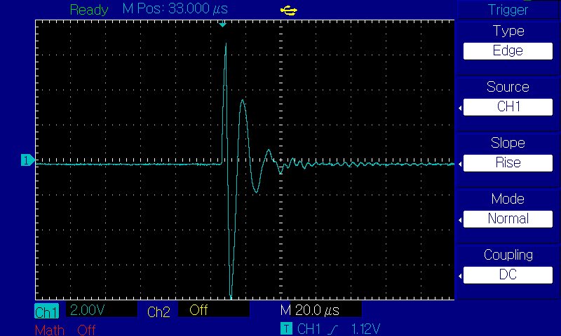

  • Dear Akeem,
    I had remove away the RC as your recommend but the result is the same for 200khz. I am currently changed the transformer to N1342DEA-0008BQE=P3 – Murata.
    Attached the signal which probe on INP pin.
    INP
    Long Pulse (200khz)
    Short Pulse (200khz)
    Do let me know if is there anything i can do? Shall we bring this off line? I would like to show you our coding to ensure everything is okay.

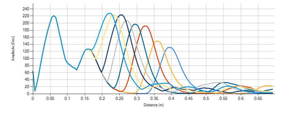

  • Hi KH,
    The N1342DEA-0008BQE=P3 transformer may not be compatible with the 200kHz transducer. The prototype transformer I used will now be publicly released as the TDK B78416A2386A003. TDK will have samples available on Digi-Key and Mouser soon. If you need samples sooner, please contact their sales support directly.
    Here are some performance snapshots of the transducer driver signal, and the echo data dump performance when using the 200kHz Steminc SMATR200H19XDA transducer when targeting a 30cmx30cm sheet of cardboard. The minimum distance is about ~5-7cm. No passives are placed in parallel to the transducer.
    Echo data dump sweep from ~5 to 60cm. The maximum distance is assumed to be +1m:
    Center-tap voltage of 9V, preset driver current limit of 500mA, and 4 burst pulses:

    There are two transducers on the EVM: the muRata MA58MF14-7N on the transformer driven, and the muRata MA40H1S-R on the direct driven.
    The muRata MA58MF14-7N is a 58.5kHz transducer, and the muRata MA40H1S-R is a 40kHz transducer. Given the relation
    ↑ Frequency :: ↑ Resolution :: ↑ Narrower Directivity :: ↑ Attenuation :: ↓ Distance
    the muRata MA58MF14-7N should be used for short range measurements. With the default components, the minimum ranging is limited to 20-30cm. To minimize the ranging of the TDK EPCOS B78416A2232A003 transformer and muRata MA58MF14-7N transducer combination, replace the parallel transducer tuning passives with a 680pF tuning capacitor (CTune) and a 10kΩ damping resistor (RDamp). This will enable sub-15cm ranging depending on the pulse count, center-tap voltage, and driver current limit.
    For 5cm mono-static ranging, you will need to acquire a high-frequency transducer (180k-400kHz), or can use two low-frequency bi-static transducers. Please read through a similar post for details on the recommended register settings and example results after modifying the EVM for optimized short ranging with the muRata MA58MF14-7N : e2e.ti.com/.../2251561

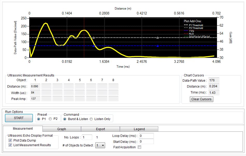

    Thanks for your advise,  I am using the muRata MA58MF14-7N transducer. Yes, from the setting and evm you advise, I can measure from 0.28m to above 1.5m. Can I confirm with you, which one is the CTune and RDamp? Is it C15 and R38? If yes, I changed the value, but the measurable distance is still the same. I am using 58.6kHz for the frequency. Need your advice.
  • KH,
    Yes, CTune = C15 and RDamp = R38.
    Are your results similar to the results shown on the following E2E post?: e2e.ti.com/.../2256046
    Note, object detection below 20cm will occur at the ringing-decay slope.
    Can you share the details of your register settings (provide GUI generated .txt output file from Memory Map page) and your supply voltage?]
    Can you share the echo data dump output for a no-object burst-and-listen command?
    I am attaching (below) the complete memory config for the updated passive tuning values . Keep in mind that the echo data dump is unreliable at very short distance. For instance, when you use Preset 2 of this configuration, it will appear as though there is no change to the ultrasonic activity prior to 14cm. However, this is due to the DSP ramp-up and downsampling. The threshold comparator is able to register the actual echo down to 10cm when you enable the Ultrasonic Measurement Results output. Do not solely rely on the echo data dump for very short range evaluation.

  • Dear Akeem,
    I am using the regmap that you provided and run the test, i found that there is an offset around 10cm from the actual measurement versus the read back. Below is my setup, do let me know if there is any incorrect on my setup? When i trying to measure the 10cm, what i read back is 20cm. For the 5cm measurement, does it means that i need to use a higher freq transducer instead?

  • Dear Akeem,
    When I enable the Ultrasonic Measurement Results, I can see the read back for distance is correct, but from the plot, i cannot see the peak that read back is correct, why this will happen?
    May I know how to get this dump data as you shown?
  • Hi KH,
    In your example screen shot, is the object actually at 9cm? The resolution within the decay profile will appear worse on the echo data dump plot due to the excessive downsampling to fit the profile in the EDD's 128 byte memory space. The ultrasonic measurement result is able to detect objects with greater resolution at its 1us sampling rate, so it can better detect objects within the decay profile.
    To plot the echo data dump as I have shown, use the PGA460 GUI. Navigate to File --> Echo Data Dump Plotter --> (opens new window) --> Open File --> (opens windows explorer to select EDD files).
