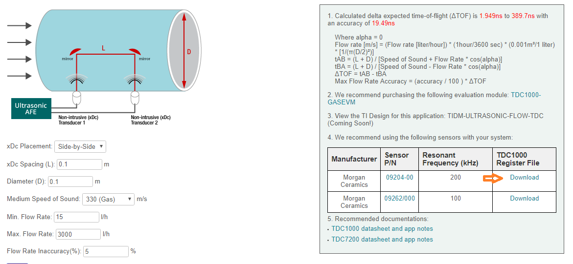

‎I have a tdc1000-gasevm board and sensors with the following features:
I want to make a gas flow meter.I uploaded the file generated by the webench designer in the tdc1000-7200 software. In the picture below, you can see my settings:
The tdc1000-7200 software seems to require 49 parameters, but the number of parameters within the generated file is 46.

please guide me:
1)What is the proper setting for my system?
2)What is the reason for the dramatic changes in data
3)Why online software does not generate 49 data for gas flowmeter
4)In the csv file, the sound speed is 1404 m/s. How can I change it to the speed of sound in the air or other fluids?
5)Why are the start_to_stop1 column numbers larger than the corresponding numbers in the start_to_stop2,3,... columns, and the start_to_stop1 numbers have severe changes, whereas start_to_stop2 numbers do not have significant changes (even with the flow by the hair dryer)

  • Hi Arman,
    I'll answer your questions from the first post:
    1. Your settings seem quite good for this distance measurement. The only thing I might change to try something new would be to increase the number of TX pulses. You could go up to 14 without having to change the HV en period.
    2. It doesn't seem to be reading properly in the GUI. I suggest decreasing the measurement frequency to once every 500ms or so to allow the slow GUI communication more time.
    3. The online configuration generator was originally developed for an older version of the GUI that did not include those extra values. Just load the configuration file into the GUI, ignore the warning, then save the configuration from the GUI. When you load it again those extra parameters will be included.
    4. You cannot change the speed of sound for the automatically generated flow measurement calculations. You will have to set up the calculations yourself in your spreadsheet.
    5. Your settings only measure a single stop. Anything after the Start to Stop 1 is not valid.
    6. The period of the measurements is determined by the setting on the first tab of the GUI. If you know the start time for the first measurement you can add that period to it for each subsequent measurement to find the time it was taken. The GUI will not auto-generate this.
