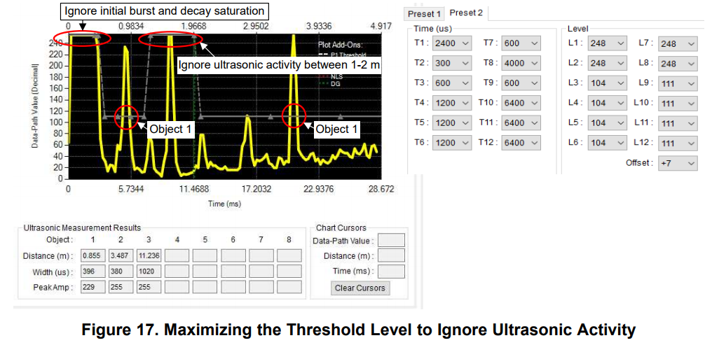

    I have some issues with what I call multiple echoes. If I put a large target in front of my transducer, the ultrasonic wave is making multiple round trips, generating false echoes. In fact, it is not a huge problem because all I need to know is the location of the first target. But if the target is getting closer to the transducer, close enough to entering into the dead zone. Then the PGA460 is reading the false echo. What I would like to do is to freeze the measure value at the dead zone distance when my target is in it.
    Do you think that is possible? If it is do you have any advice for me?

    Section 5.2 of the PGA460 FAQ (www.ti.com/.../slaa733.pdf) discusses how to implement echo masking by saturating the threshold levels. If you'd like to ignore activity in the dead-zone, then I recommend that you initially saturate the threshold to prevent inaccurate measurements.
    5.2 How can I detect more than eight objects? Can I set the threshold to ignore ringing decay ripple or objects for a given time after bursting? How can the Threshold Offset be used?
    The threshold map can be set to ignore ultrasonic activity at any point of the record window, when the threshold level is set to a value of 255. The user may want to consider setting the threshold to a value of 255 during the initial burst and decay time. Even when the return data is saturated, such as during the burst window or strong return peaks, the threshold comparator will not trigger when the threshold is maximized. For threshold levels 1-8, the value of 255 can only be attained when the threshold level is maximized to a value of 248, and the threshold offset is set to a maximum positive value of +7. This offset applies to all 1- 8 levels. For levels 9-12, the offset does not apply, and these levels can be independently set to 255.

    (2) Refer to Section 5.2 of the PGA460 FAQ (www.ti.com/.../slaa733.pdf) which discusses how to implement echo masking by saturating the threshold levels. You need to set the level of the first eight threshold points to 248, but also set the threshold offset to +7 to set the final value to 255. This will prevent any echo activity from triggering the threshold comparator.
