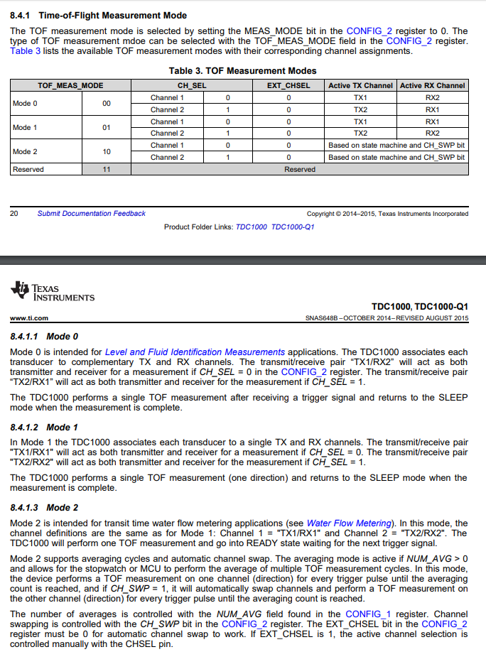

I'm working with the board TDC1000 & TDC7200 EVM. I use this EVM with a PZT transducer of 3.4 MHz and a reflector to get the concentration of my fluid using the ToF measured and it works perfectly. Knowing that the RX1/TX2 are connected between them. But now i want to use two PZTs one as emitteur and the other one as receiver. I didn't find any documents about how to use two transducers in fluid concentration measurement. So my questions are :
1- Is it possible to use two transducers of 1 MHz up to 3.4 MHz in fluid concentration measurement using this EVM? the distance between the PZTs is 35 mm.
2- What are the configurations that i should do to have a transducer as a receiver only and the other as transmitter?
3- If we can't do this with this board, can i use the TDC1000 gasEVM instead of the first one? how?
Please i need you're help as soon as possible. Thank you
    Yes, it can be used in this way. You will need to set the measurement mode to 1. The datasheet describes the measurement modes here:
  • Hi Scot,
    Thanks for your answer.
    so if i understand clearly, when I configure to mode 1 and choose CH_SEL to 0 i will have : transducer A which is connected to pin 8 (TX1) of the EVM, it will work as receiver. The transducer B which is connected to pin 12 (RX1) of the EVM, it will work as transmitter.
    is it okey?
    The ToF that i will get from the GUI is it the one for a one way wave or I have to calculate it from the oscilloscope?
    thank you :)
    If CH_SEL is 0, TX1 will be the transmitter, and RX1 will be the receiver.
    The TOF you see from the GUI will be the time from when the TX starts to when the RX receives the signal, so it will be one way.
