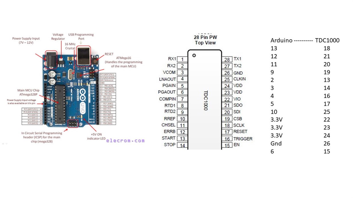

I am trying to use the TDC1000 with the Arduino Uno, which has the Atmega328p MCU. I am currently only using these two devices and not the TDC7200. My problem is I am not receiving a start signal from the TDC1000. The Arduino is sending a trigger signal to the TDC1000 and by measuring the 1Mhz ultrasonic transducers that are also attached to the TDC1000, there is a Tx and Rx signal from the transducers. The enable pin on the TDC1000 is also pulled high. Could you help me figure out the reason why I am not receiving a start and stop signal.
Many Thanks,
