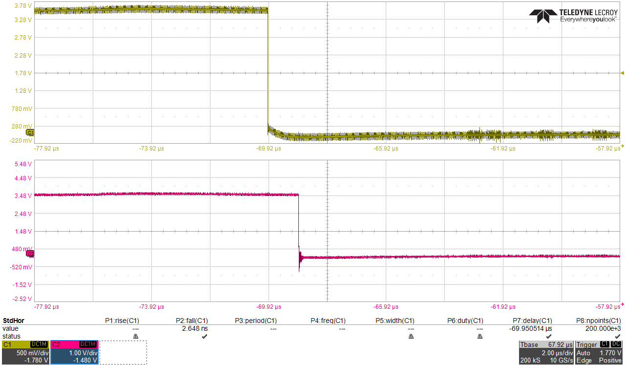

Good morning,
I'm using a TDC7200 to measure the ToF. Up until this moment, I've successfully configured all the registers and I'm able to see the interrupt on INTB pin. The TDC is configured to operate in Mode2 (16MHz external CLOCK), with a single STOP, 2 Calibration cycles at the end and with START, STOP and TRIGG at falling edge. The NEW MEASUREMENT and CLOCK_COUNTER_OVF Interrupts are enabled while the COARSE_COUNTER_OVF is disabled in INT_MASK. I've set the CLOCK_CNTR_OVF to several different values and the interrupt instant on INTB responds accordingly. For e.g., in the images below, I've set the overflow condition to 1us and 4us and one can see the INTB pin (Red signal) switching at the right time after the falling edge on START (yellow). I've also verified the INT_STATUS register after each interrupt and I obtain 0x1D (Clock overflow detected). The problem I'm facing is reading the CLOCK_COUNT1 registers. In principle, I should read the same value set on the CLOCK_CNTR_OVF. Whatsoever, I'm always reading 0.
Can someone please point me out the problem? The code I'm using is also shown below (MSP430FR5969 microcontroller).
Thank you very much,
Joaquim
P.S.- In the meantime, I've done some tests with an external STOP signal and the TDC seems to be unable to detect it and continues to interrupt at the time defined through CLOCK_CNTR_OVF.
